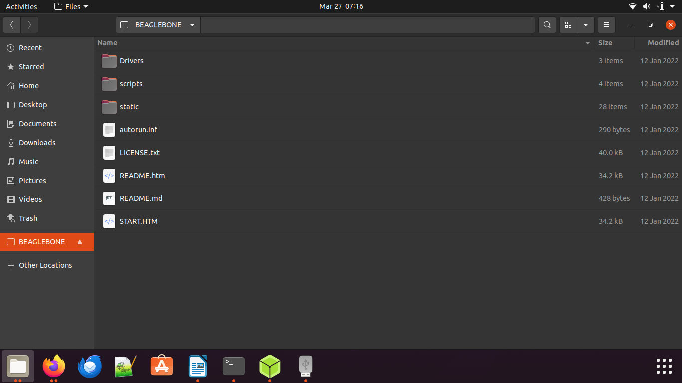

    6. Double clicked on mounted BEAGLEBONE (Orange).
    7. Received the error- screenshot below:

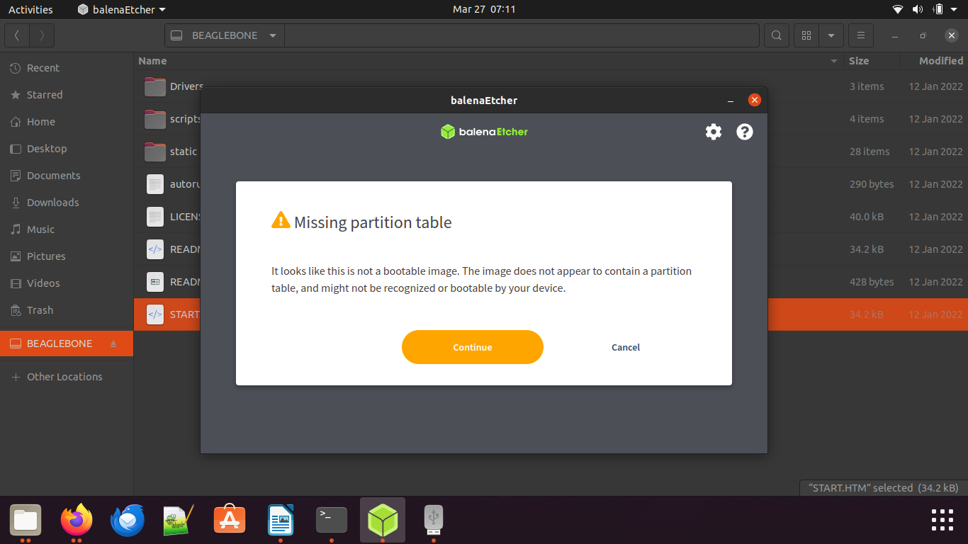

I uninstall old balena and reinstall new from your given link afterwards I flash new sdcard with am335x-debian-11.7-iot-armhf-2023-09-02-4gb.img.xz image, but again same problem Missing partition table when clicked on START.htm. How should I fix this issue ?
My doubt is img.xz file also, which exact file should I use here ?

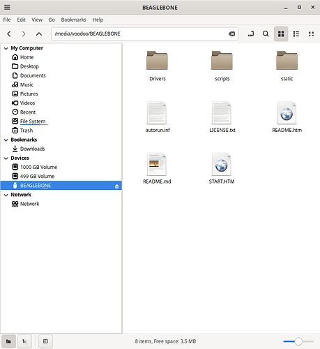

No Belena/etc has nothing to do with the final image… I need to look at am335x-debian-11.7-iot-armhf-2023-09-02-4gb.img.xz and see what we actually ‘export’ over USB-flash emulation…

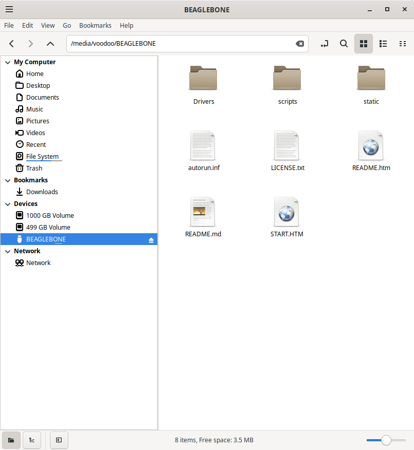

Yeap, this is the default image that will show up over the usb-flash drive:
Why is ‘etcher’ opening when you double click the “BeagleBone” ‘flash’ drive…
the “usb-flash” drive from the BeagleBone is a small emulated usb-flash image… it’s Read Only…
sde           8:64   1    18M  1 disk
└─sde1        8:65   1    17M  1 part /media/voodoo/BEAGLEBONE
If this is the image problem, from which image , i should try ? and how can u kindly give the process to suit with latest…regds.
I think this is the very point: @Ankur your Ubuntu is somewhat misconfigured, open that HTML file with a browser of your choice.
Furthermore, you might want to get into the beaglebone. I don’t remember exactly the login credentials (root / empty pw?), but the usb connection should also offer you a new network connection, which you can use to ssh into the beaglebone: ssh root@192.168.7.1
That’s right this was a bug in etcher… Etcher AppImage registers itself as default text/html mime handler · Issue #3374 · balena-io/etcher · GitHub
so it takes over all html…
another reason to not use it anymore…

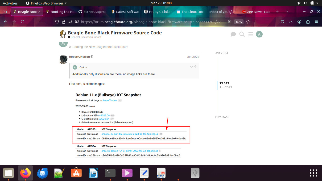

Earlier also I tested BBB board i.e. some 2 years back that time Robert you yourself give the image link Beagle Bone Black Firmware Source Code - #22 by Ankur,
yourself given this, but that time it worked well, but now i m not able to find the same image, adjacent i tried but facing this issue.

While i’m bringing back the ‘fat’ partition for EU/UK cyberlaws (sysconf.txt), we have not had a ‘boot’ partition for over 10 years on BeagleBone Black / am335x devices images.

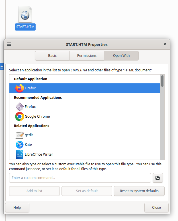

The issue why “etcher” complains after you click the “readme.html” is a bug in etcher taking over *.html links on your system.
Next time, right click on the “*.html” file, select “properties” and “open with” back to firefox/etc (or reset to system defaults)…
