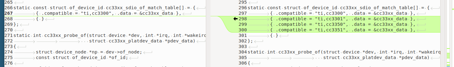

Now installing 6.12.x
first problem, the wifi node wasn’t enabled in our 6.12.x device-tree..
Got it, ti’s v6.12.x dropped some of the compatible’s..

Pushed fix: fix: beagley-ai: wifi was not enabled (fcf131a3) · Commits · Robert Nelson / ti-linux-kernel-dev · GitLab
Test Kernel in a few minutes: build-debian-12-amd64 (#10454088821) · Jobs · Robert Nelson / ti-linux-kernel-dev · GitLab
you can test via:
wget https://gitlab.com/RobertCNelson/ti-linux-kernel-dev/-/jobs/10454088821/artifacts/raw/deploy/linux-image-6.12.24-ti-arm64-r42.1_1xross_arm64.deb
sudo dpkg -i linux-image-6.12.24-ti-arm64-r42.1_1xross_arm64.deb
tagged as 6.12.24-ti-arm64-r43 coming thru apt…
