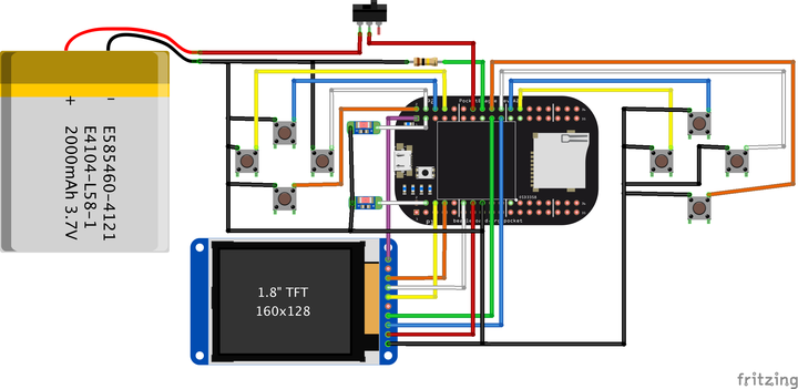

For my example, I’m going to look at the “simple gaming” hack-up board I did for Maker Faire New York. You can find the project entry at bbb.io/+f96db4, but the breadboard view associated with my latest prototype is below.
Ignoring the battery charger for now, for which I haven’t added support, there are 3 key elements requiring drivers: the LCD, the keyboard buttons and the LEDs. Each of these can be tested using run-time configurations, but let’s look at the steps required to create the device tree overlay.
