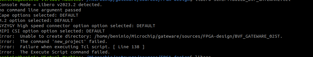

I have also issue when running the libero SCRIPT:BUILD_BVF_GATEWARE.tcl
I don’t know how to solve it
What command did you invoke to get this error? It looks like you are directly calling the Libero TCL script instead of the build-bitstream.py script. It also looks like you have some directory permission issues. Please check you can create a file in that directory.
you were right saying that I didn’t have permissions on some folders and sub folders. I just change the ownership t $USER and the problem was solved!
