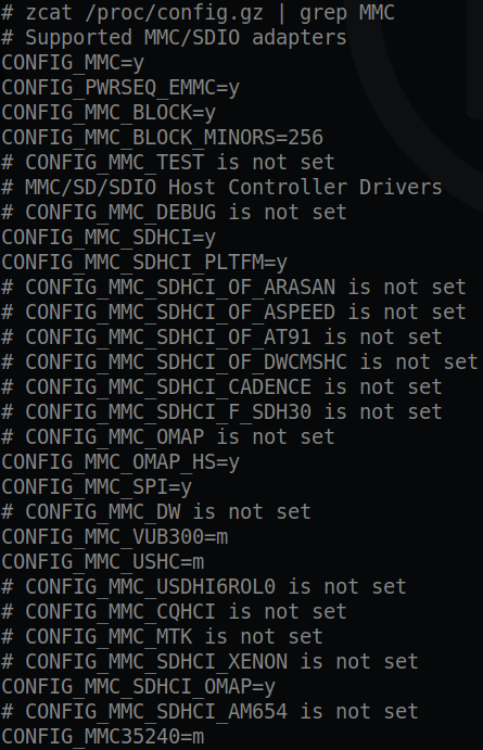

First thought, do you have eMMC enabled or disabled?
This is the kernel configuration

These are the version I’m using
buildroot 2021.11 (beaglebone_defconfig)
u-boot 2021.04
I want to upgrade the MLO on eMMC, but I don’t know how to enable eMMC
This is the mmc devices printed on my board.
