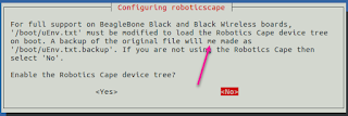

I found a typo…
–Mark
I found a typo…
Here’s the source line with the typo:
https://github.com/StrawsonDesign/Robotics_Cape_Installer/blob/628d329da7bfc6fb5a37b79664ebbd558310e856/debian/templates#L5
Don’t think we need to have this fixed necessarily before making the latest-images release, but this is where we can make the pull request to if James doesn’t fix it himself.
fixed in commit 08f600eb473a3cbc3fdf4ec0113f5269650a060a
I like these easy ones ^.^
