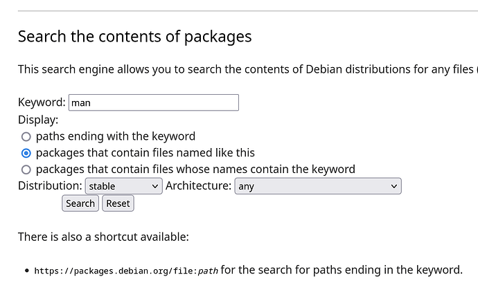

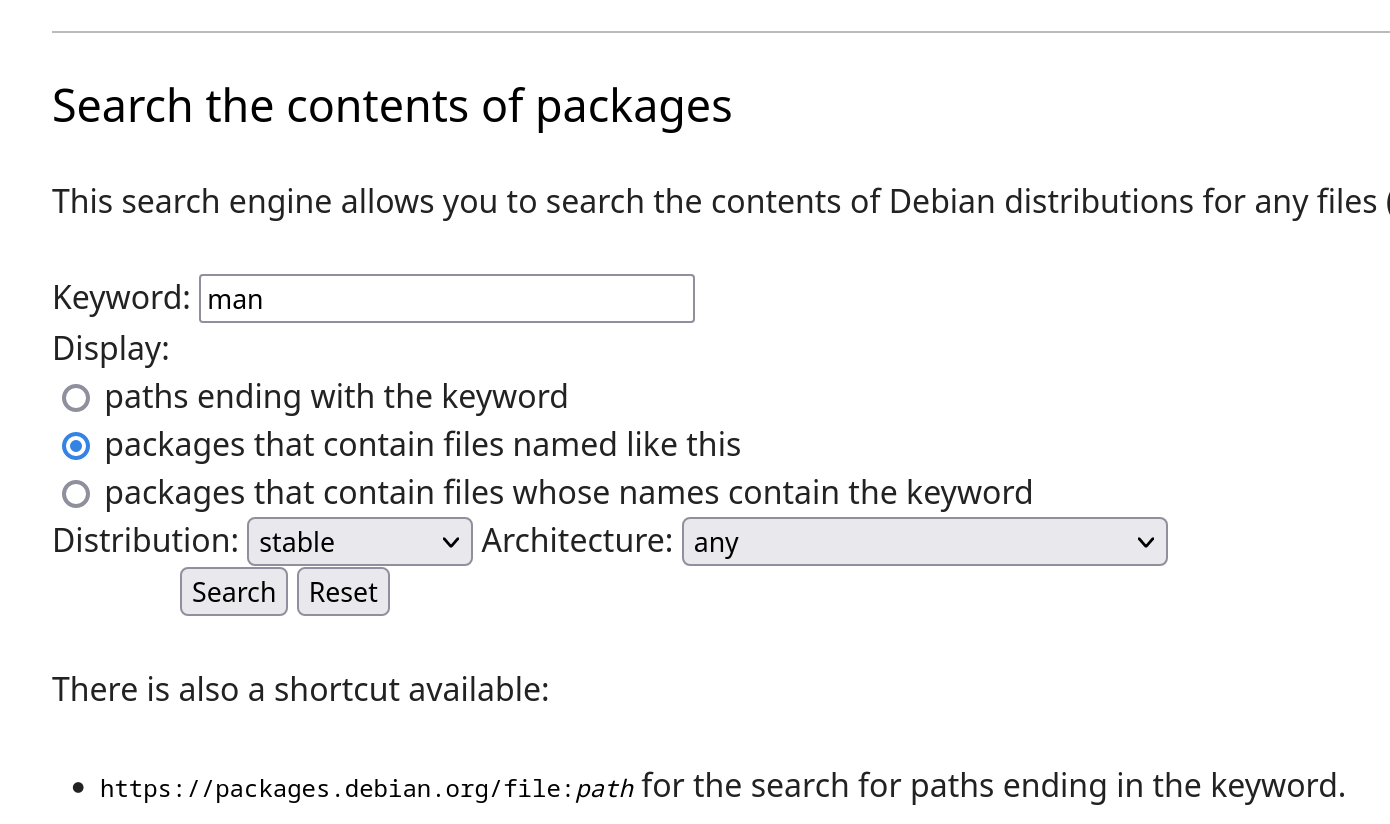

The easiest way to do a binary search for debian packages is: Debian -- Packages
