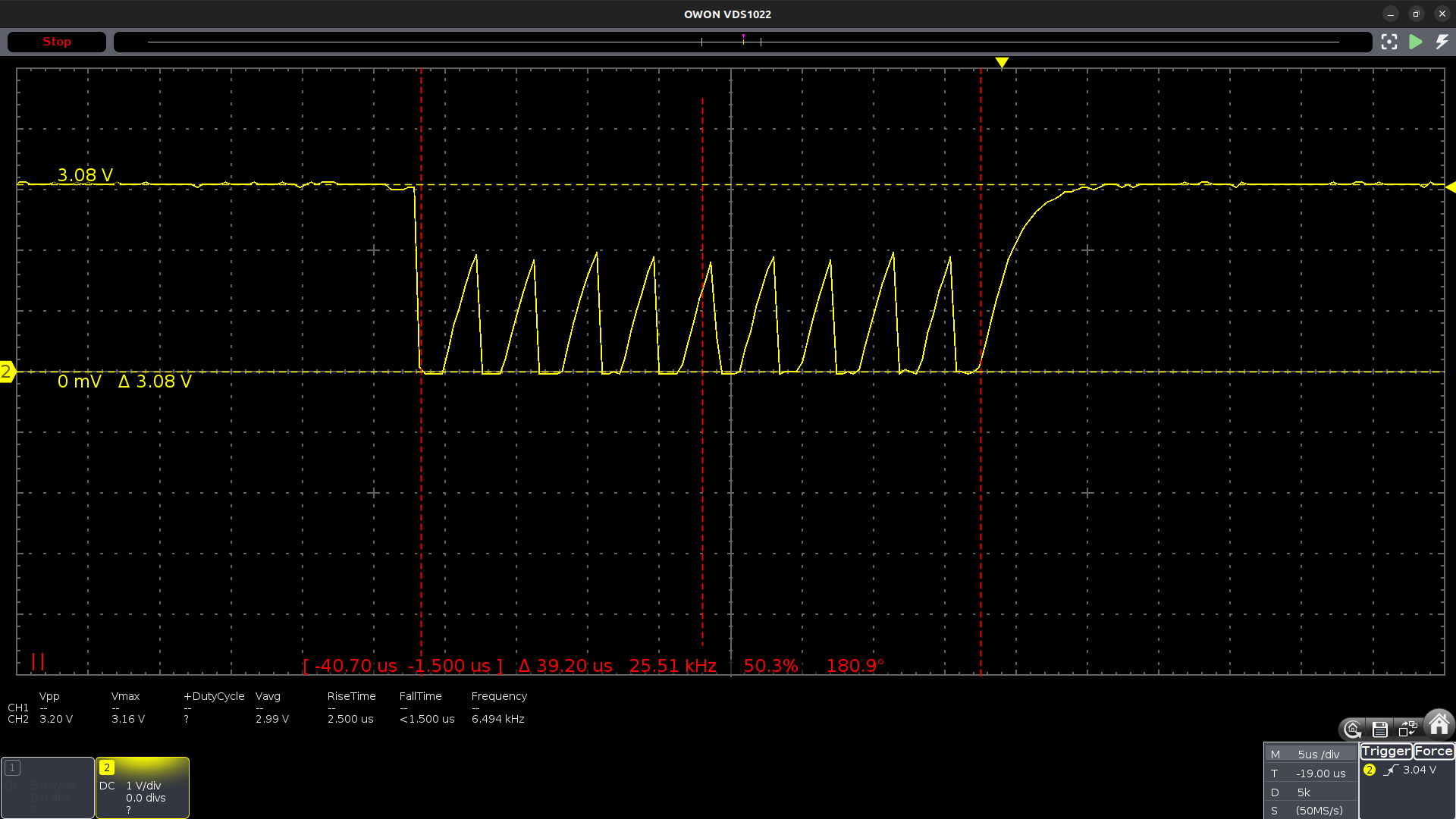

I want to lower the I2C clock frequency on i2c1 because I have long leads to the temperature sensor LM75.

The sensor works just fine on other platforms.
This is also how the clock looks currently on the oscilloscope:
