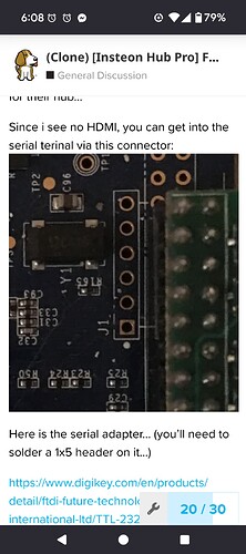

I still say, solder a header on j1 so you can see what u-boot is doing.
You’ve been only debugging by LEDs for years, without knowing what u-boot is complaining about..

Everyone is just guessing at this point and does NOT have this specific hardware. You have the hardware, solder a header to j1 and show us what it does on boot-up.
Well, that requires that I learn to solder, buy a header, and risk my hardware to do the work. Isn’t it easier just to figure out which is the latest Debian that will run, and then upgrade it?
June 2022 (the last time i asked you)… to today… August 2025…
Plenty of time.
Solder 3 wires, go to a university or a hack-athon, would take you 5/10 minutes.
After that u-boot will show you exactly what it’s trying to do and we will have an answer for you..
Otherwise, it’s NOT our board, it was designed by Insteon..
