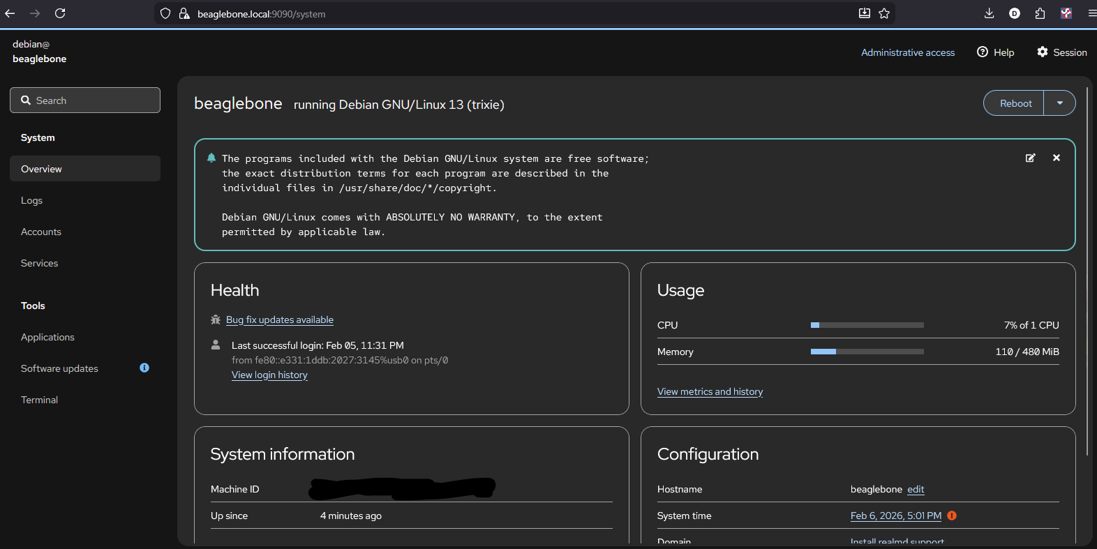

FYI, I had to click past a self signed certificate warning and accept the risk to continue in Mozilla, but the new Cockpit web console is really nice too. I assigned “beaglebone.local” in the image writer rs tool, and have DHCP working.

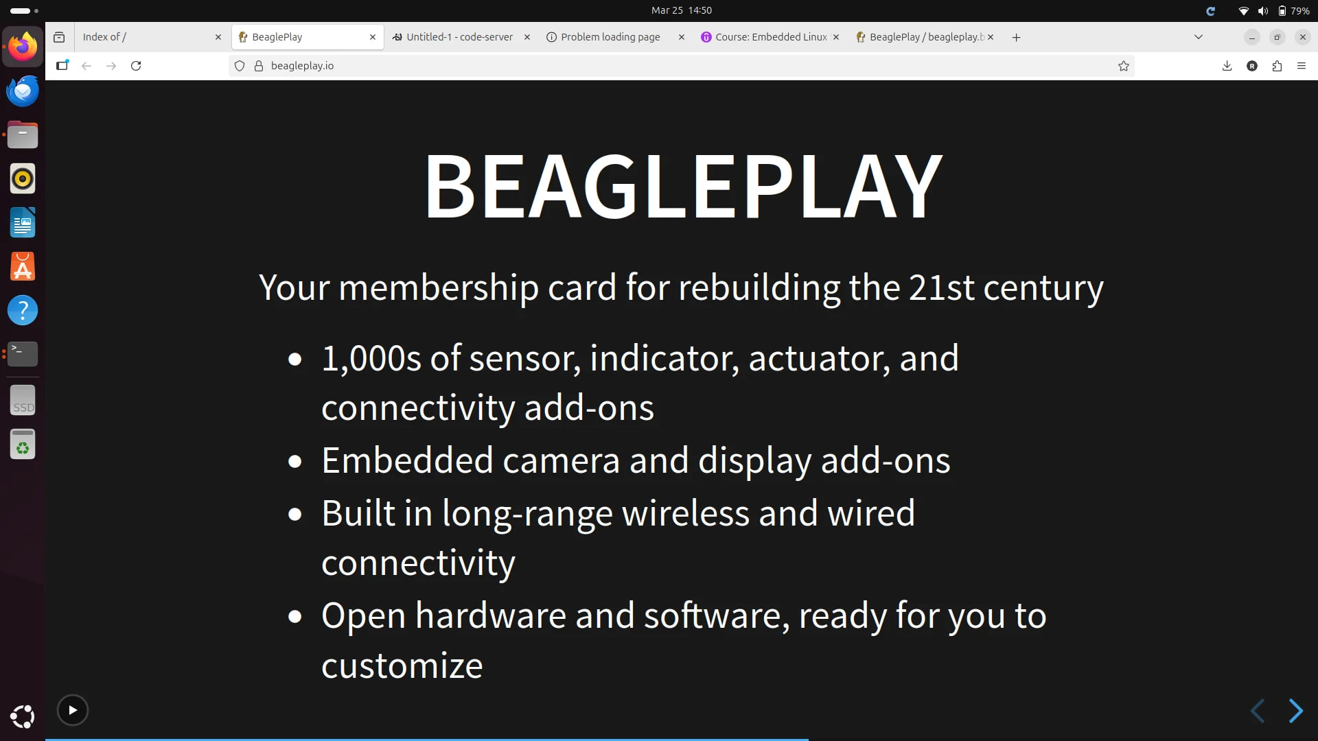

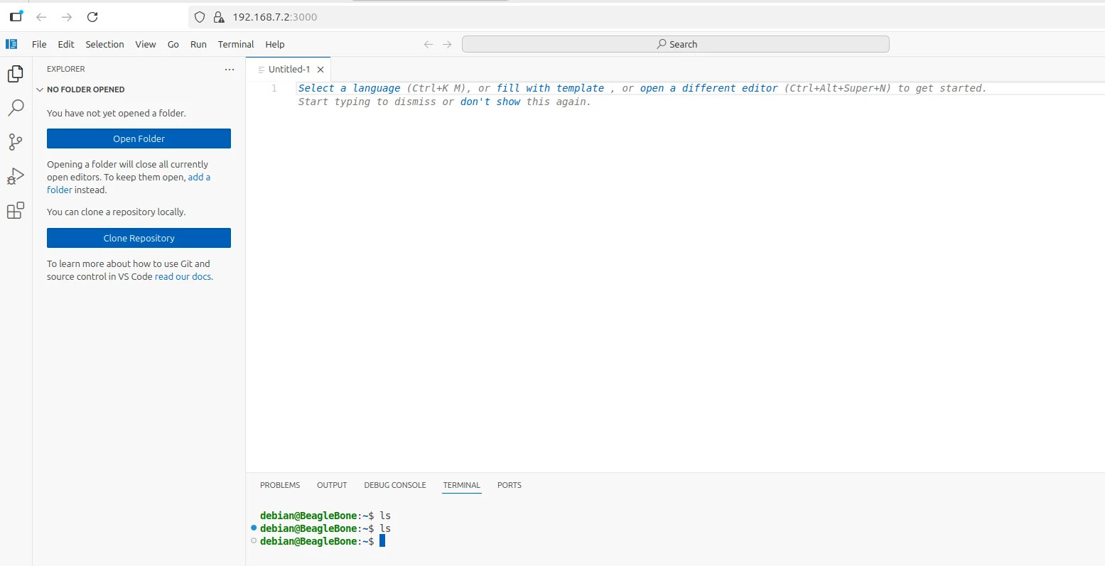

In this only Beagleplay.Io and VScode.html are able to open.Below are the screenshots.
In the VS code I opened the ternimal and in beaglebone there are no scripts present in the to execute. Can you help me on this please
