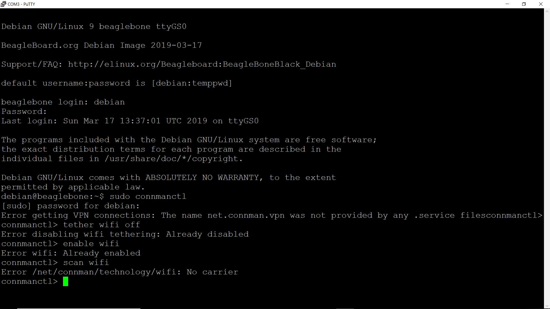

I’m running Debian 9 on my Beaglebone Black Wireless board.
I tried the commands present in the screenshot.
I’m not able to connect my BBBW with a network.
Any help would be grateful.
Thanks.

Please -- in the future don't inflict large low-resolution screen grabs
on us... It's a text console -- select the text, copy, and paste into the
message. It is painful having to save a 30+kB attachment to the computer,
find the saved file, then open it with a graphics viewer/editor (and later
delete the attachment), when text is less than 2kB of data. The image is
also limited to the size of your console whereas text selection can use the
scroll-back buffer and get a lot more lines.
Based upon the error messages, there is nothing wrong with the
hardware... But lots wrong with the configuration files (it appears to be
looking for a configuration file for some VPN connection which is not
found)
Your image also does not show the results of the version data R. Nelson
requested...

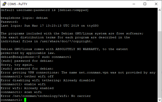

Your board is acting strange, can you please test this test image:
Thanks for correcting me. I’ll follow that way hereafter.
I tried the new image, you gave me. I got the following output on running the connman commands.

debian@beaglebone:~$ sudo connmanctl
[sudo] password for debian:
Error getting VPN connections: The name net.connman.vpn was not provided by any .service filescoconnmanctl> tether wifi off
Error disabling wifi tethering: Already disabled
connmanctl> enable wifi
Error wifi: Already enabled
connmanctl> scan wifi
Error /net/connman/technology/wifi: No carrier
connmanctl>
Please help me with it.

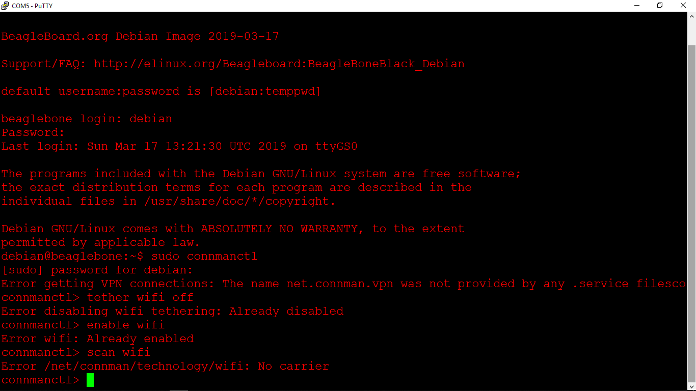

Debian GNU/Linux 9 beaglebone ttyGS0
BeagleBoard.org Debian Image 2019-03-17
Support/FAQ: http://elinux.org/Beagleboard:BeagleBoneBlack_Debian
default username:password is [debian:temppwd]
beaglebone login: debian
Password:
Last login: Sun Mar 17 13:21:31 UTC 2019 on ttyGS0The programs included with the Debian GNU/Linux system are free software;
the exact distribution terms for each program are described in the
individual files in /usr/share/doc/*/copyright.Debian GNU/Linux comes with ABSOLUTELY NO WARRANTY, to the extent
permitted by applicable law.
connmanctl>
