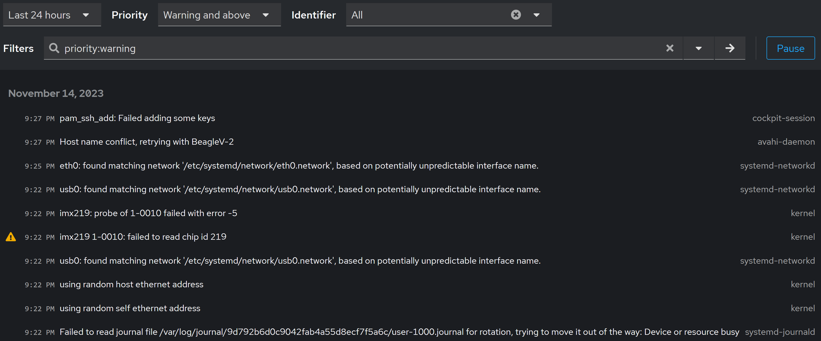

I sudo apt updated && upgraded and after reboot I looked thru the logs on the web interface.
Don’t know if this sheds some light.
