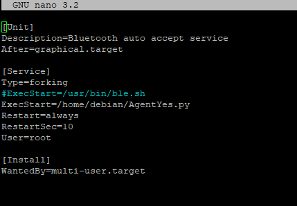

If you want help, share your current service file.
Thank you Robert, This is the service file
User=debian, but you want to use ‘sudo’… ? that means just run as root, don’t use User with sudo…
Type=simple → forking…
[Service]
Type=forking
ExecStart=/home/debian/AgentYes.py
Drop the Restart for now…

[Unit]
After=graphical.target

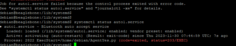

Tried above solution it fails to start service.
and this is the updated service file.
Hello Robert, Please help ! I need your help

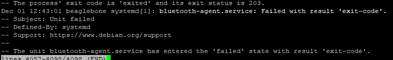

Did you run journalctl -xe as the output suggested ?
Your python script exited, probably nothing to do with the service file.
it runs yesterday, but suddenly it showing this error.
thats the output when it runs successfully.

output of journalctl -xe
