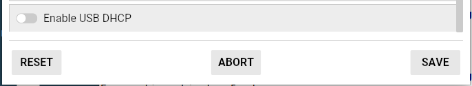

On windows 11, its’ best to enable Internet Connection Sharing.. Then thru ‘bb-imager’
Toggle this option:
It still doesn’t always work on windows thou..

For Windows 11, enable ICS, and Enable USB DHCP in the flasher software: BeagleBoard Imager
