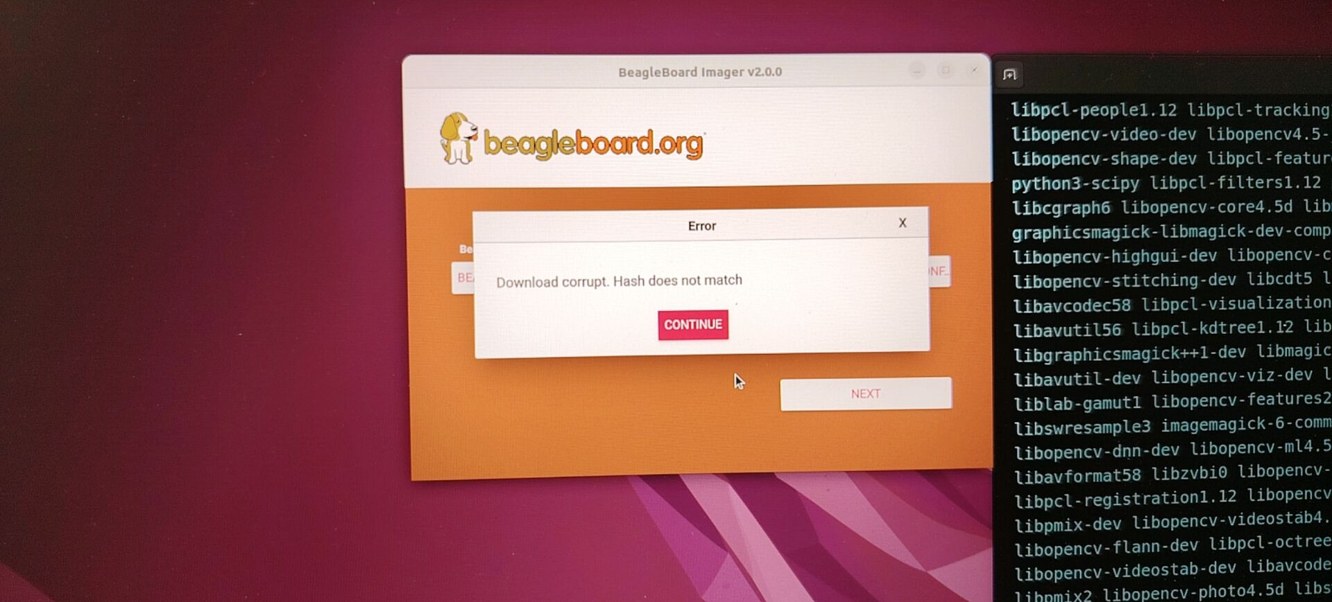

Download corrupt.Hash does not match.
The image file I’m using is beagley-ai-debian-12.5-xfce-arm64-2024-06-19-12gb.img.
I have tried the following solutions:
  1. I re-downloaded the image file to ensure that the file was not corrupted.
  2. I used different burning tools
  3. I checked the storage device to make sure it was not damaged. I reformatted it and tried burning again, but the problem still exists.
    If anyone has encountered a similar problem or knows how to solve it, please share your experience and methods. Thank you very much for your help!
This is a known issue with the 2024-06-19 uploads. At the time I didn’t know, but each file was uploaded to the same directory so when I uploaded a v6.1 and v6.6 kernel builds with the same name they override each other.
This has been fixed and I uploaded new builds last week.
