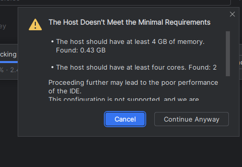

does the personal version of clion work for this?
looked at their pricing, i can live with the personal version, if it works
some hefty requirements, 4G ram, 4 cores.
beaglepocket 2 doesn’t even get close

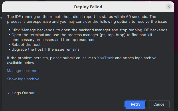

seems to be resource hungry, took all memory plus 512M of swap.
You need to set it up differently, the core application only runs on the host and handshakes/uploads files to the target. The setup for remote is not very well documented. I will have some more time this late weekend and post some screen shots. The weather is getting better and I have plenty to do at the farm.
