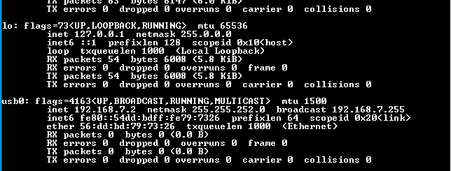

After reboot, we have usb0 up as well
But I still can’t ping 192.168.7.2 from my pc. Anyone know what I am missing?
