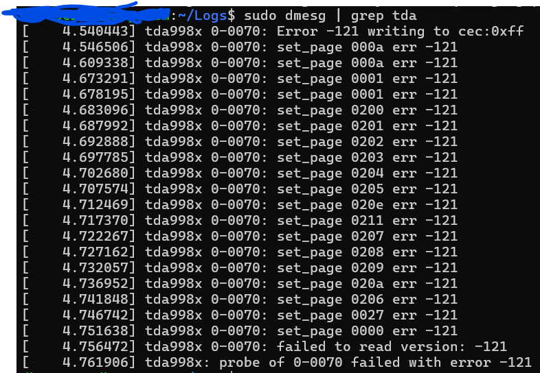

What if we aren’t using HDMI, but that line isn’t set? AKA #disable_uboot_overlay_video=1 or disable_uboot_overlay_video=0
Will it just log a i2c error? If so, does it print it a couple times and then stop? Or does it flood the logs nonstop(and then possibly waste lots of cpu cycles?) and burn out the eMMC?
EDIT:
I see no indication of flooding of logs/wasting cpu cycles/etc. I just see it print out some errors once at boot. Whether you have an HDMI cable plugged in or not doesn’t change anything. Aside from not displaying an image…
#disable_uboot_overlay_video=1 results in logs printed at boot(see attached image)
disable_uboot_overlay_video=1 or disable_uboot_overlay_video=0 results in no logs printed. You would think disable_uboot_overlay_video=0 would be equivalent to #disable_uboot_overlay_video=1 but it’s not, which tells me the number doesn’t mean anything.
If you have a display plugged in like a GEN4-4DCAPE-43CT-CLB – 4D Systems that automatically loads the BB-BONE-4D4C-01-00A1 overlay, then the errors don’t print no matter what. Seems to block the TDA driver from loading.
So if you don’t use the HDMI port, you shouldn’t expect any problems, irrespective of the disable_uboot_overlay_video flag in uEnv.txt
Tested in 5.10.145-ti-r55…
