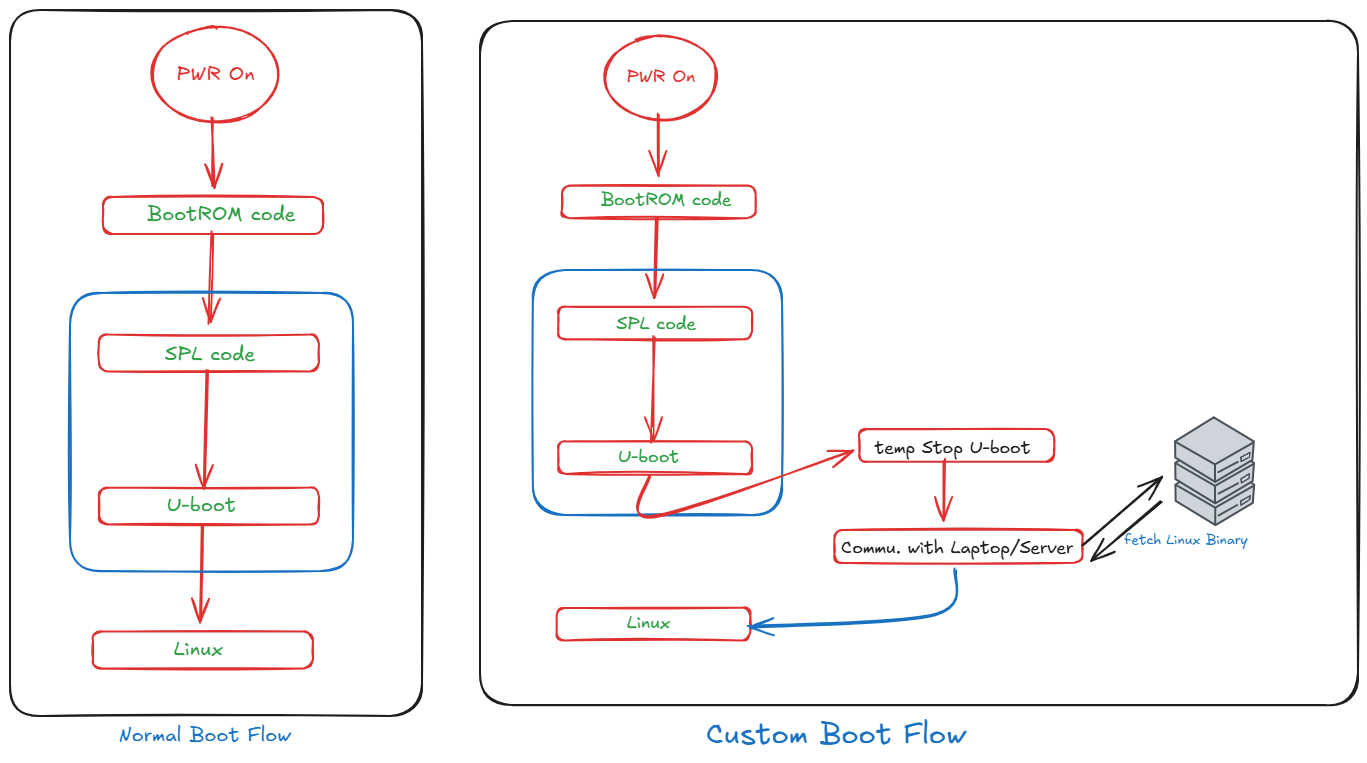

Hi BBB community,
I’m setting up my development environment and need to transfer a kernel image from my laptop to the Beagle Bone after u-boot.
Could someone guide me on the best way to do this?
