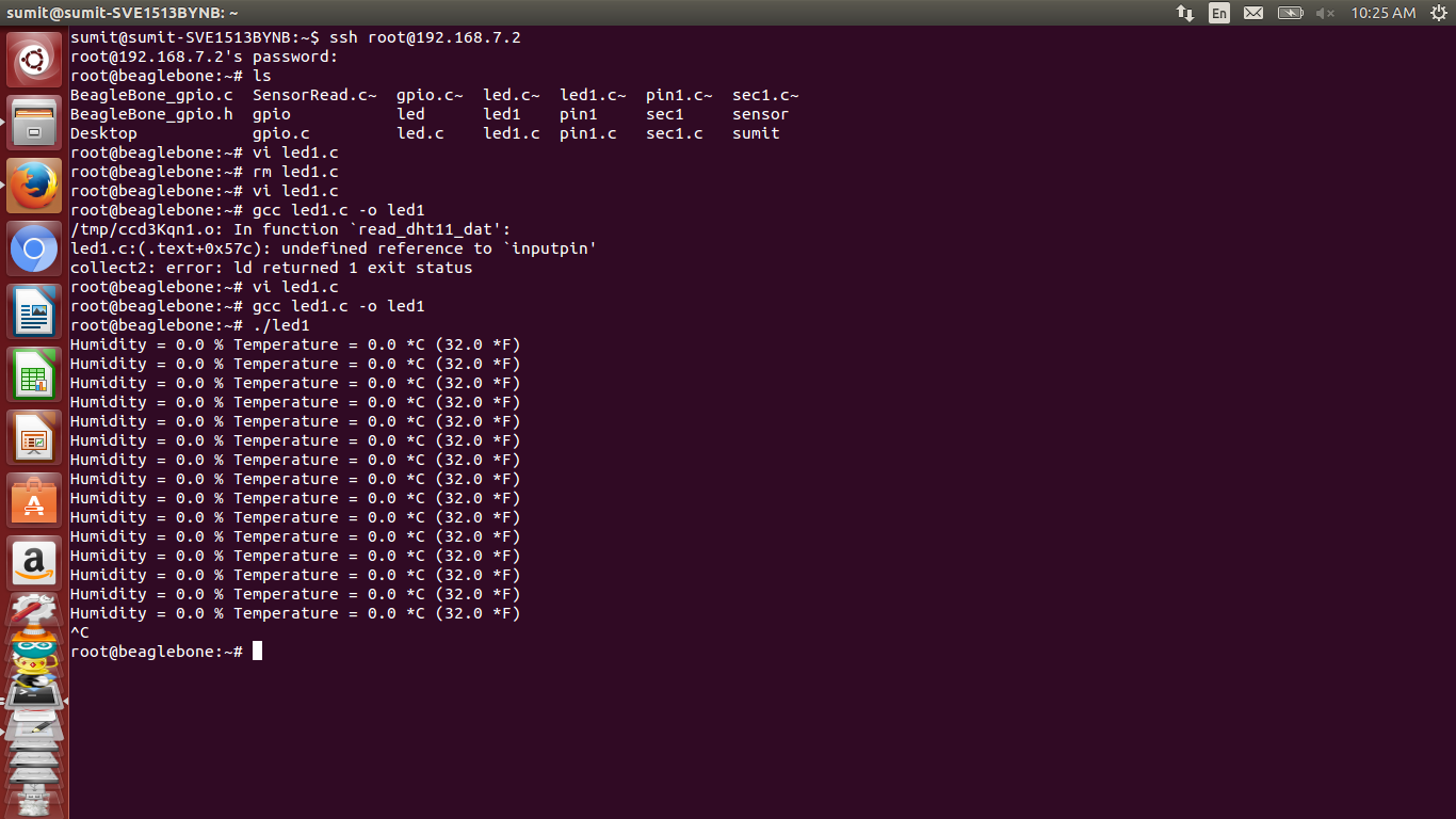

Hello friends,
I’m compilited this code for interface BBB with DHT11(temperature-humidity sensor) this code is compiled and run successfully but OUTPUT
is 0’c temperature - 0% humidity …
Plz , find error this code…
Code-

Screenshot from 2016-03-22 10:25:06.png

I've not checked the dht11 spec sheet, but this (blast -- whatever
format your text is in I can't seem to cut&paste a second block -- it seems
locked onto the stuff I copied above)... The loop where you "skip first 3"
looks like it also only takes every other transition (i%2) -- does the
DHT11 return to 0 between every data bit?
  Okay -- spent lunch with a data sheet.
  Take-aways: Each bit is started with a low state, and then 0/1 is
determined by the length of the high state that follows. Given that, I'd
skip the modulo and "last state" stuff, and explicitly look for the
inter-bit "low", then look for the bit-data high.
  In pseudo-code (based off of Python)
Hi, Dennis Lee Bieber
Thanks for the valuable effort but i am unaware of the python language and hence it would be really appreciable if you could provide me your help in C/C++ language only.
On Thu, 31 Mar 2016 00:16:28 -0700 (PDT), Sumit Bhut
<smbhut@gmail.com> declaimed the following:
  The best I could provide then (since I've not learned the build tool
chain on the BBB, and don't know if I even have a DHT11 in my box of
assorted cheap sensors) is to point you to a working implementation for the
Arduino.
Arduino Playground - HomePage IS C++, and includes timeout
errors if it doesn't get a response
  Obviously you'd have to replace all the I/O (digitalWrite(),
digitalRead() [though the latest library looks to be doing direct I/O port
reads and masking to get the pin], and delay() stuff) with BBB equivalent
functions.
  The main function is at the bottom of the page: _readSensor()
  And, as I suggested in the "Python" pseudo-code, there is no fiddly
game using a modulo function to follow changes in the pin state. You know
the protocol always uses a LOW state to start any stage (wake-up, response,
start of bit) followed by some duration of HIGH state (pretty much
irrelevant for the wake-up/response; only the 0/1 duration is significant).
Therefore, reading the sensor should explicitly look for LOW and HIGH
conditions. Your modulo doesn't know which state it is in -- if you started
testing when the sensor had the line in the wrong state, you could be
counting the length of the start of bit LOW, rather than the bit HIGH
period.

under an oscilloscope. Even when manually setting the pin value using the
  echo 1 > /sys/class/gpio/gpio#/value
from a command line. I could read back the 1 (or 0) value, but never found
a level change on the 'scope -- the pin was either tied high, or tied to
ground.
  My last version is showing some activity, but is still failing, as
shown (I'm wondering if usleep() has some obscenely large granularity on
the BBB, because it took 53 seconds to go from "beginning measurement" to
the first timeout error on the first byte, sixth bit):
debian@beaglebone:~$ sudo ./DHT11
Beginning measurement pass
Timeout counting bit length 0 5
***** Error while reading sensor
Timeout counting bit length 0 6
  Even worst case (all 1 bits) the entire data read (40 bits @ 120 uSec
each) is less than 5 msec, and the 20 msec wake up brings the total to
around <30 msec... So where did the other 53000 msec delay come from?
debian@beaglebone:~$ date && sudo ./DHT11
Sat Apr 2 21:25:45 EDT 2016
Timeout counting bit length 0 3
Timeout counting bit length 0 4
^Cdebian@beaglebone:~$ date
Sat Apr 2 21:27:37 EDT 2016
  Based upon where it is timing out, the code must be seeing some
toggling of the signal coming in, or it is reading atmospheric noise; as it
gets past the bus available, wake up response, and a couple of data bits --
all actions that require seeing a LOW then HIGH sequence.
  Maybe next weekend I'll have time to convert the deprecated usleep()
into current POSIX nano_sleep(). In the meantime, my code follows. Compile
with
g++ -o DHT11 DHT11.cpp -std=c++0x
o/~ I'm Talking to Myself in Public o/~
On Sat, 02 Apr 2016 21:37:26 -0400, Dennis Lee Bieber
<wlfraed@ix.netcom.com> declaimed the following:
I attempted to generate something in C++ which took hours. For some
reason I can't seem to find a GPIO pin that was actually toggling when
ground.
  Actually, I suspect it's the overhead of all the I/O calls needed to
access GPIOs via a pseudo file system.
  After all, to detect a 0 bit, requires being able to do three at least
six I/O function calls in 27usec (the HIGH period of the bit --
open/read/close to detect the transition to HIGH, and open/read/close to
detect the end transition back to LOW -- and preferably multiple cycles to
get some idea of the length)
  Might need to try the mmap route... Hopefully won't need the PRU.

Here also the problem remains the same as in my code, we are not able to initialize the DHT11 sensor somehow… but yeah on a surprising note this link proved to be quite handy in fetching the data from the sensor though as i am not acquainted with python, whatever is happening inside the code is mysterious to me.
https://learn.adafruit.com/dht-humidity-sensing-on-raspberry-pi-with-gdocs-logging/software-install-updated
initialize the DHT11 sensor somehow... but yeah on a surprising note this
