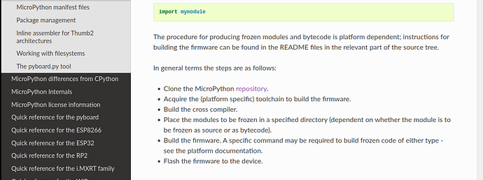

Have you had any luck trying to find the actual important information regarding building it?
Did find this and then the trail stops.

@foxsquirrel - I thought about bundling the main.py inside the firmware, but was hoping for a simpler method.
