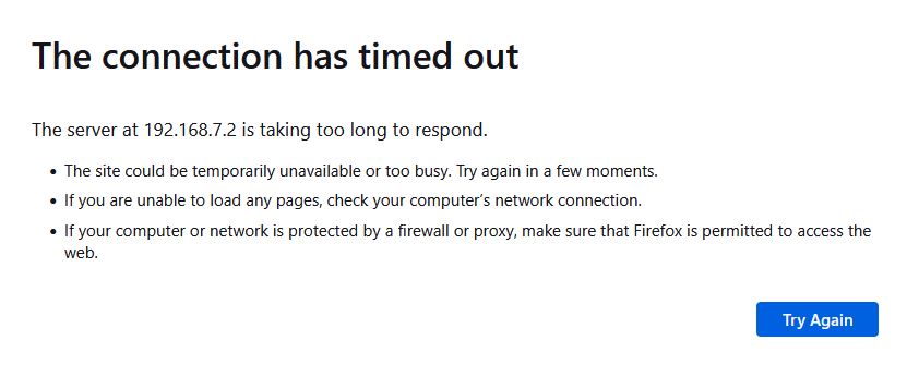

I can use the serial port console to get the PB2 to boot into the Techlab mode… sometimes. So I guess one can vaguely say “I got it working!”. But sometimes it hangs on boot and that was reported in another post and is a known issue. Straight default boot never has worked for me and there doesn’t appear to be any web server running with which to launch VS Code, as fictionalized in the Quick Start. The PB2 just isn’t ready for running working applications. It’s fine for exploring, learning and such. However, I have absolutely no doubt it will be fabulous when things stabilize a bit.
