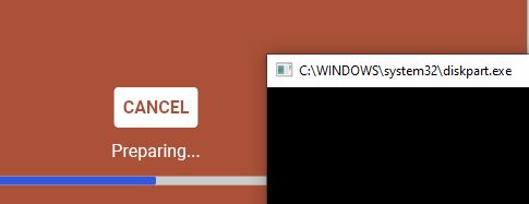

When I try to customize and click to advance to burn the uSD, it hangs up with a CMD window:
It just sits there…
If I X-cancel that CMD window, it proceeds and goes through the whole motion only to finish with a fail…

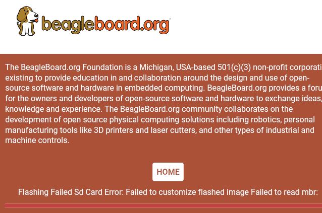

I had 2 cards here, SanDisk brand, and not that old or used and I thought they should have been fine. They did work for a while with the experiments I had tried on the BBB. Finally, one of them failed outright, doesn’t get recognized at all, and now the other gives me this error when I try to run the BB-Imager to burn an image:

This card that fails with the BB-Imager above picture I attached, it works fine with Etcher and the old BBB. I plug the card into the BBB, power up, open Putty to SSH into it, I’m in Linux, no problem.

NOPE…! NOGO!
Brand new uSD card fails with the same error as above.
This is a top quality card purchased through reliable supply chain, so it’s not some fake: https://www.bhphotovideo.com/c/product/1375051-REG/sandisk_sdsqxaf_032g_gn6ma_extreme_microsd_32gb.html
So I don’t know what else to try. The PB2 simply doesn’t want to cooperate with my WIN10 setup.
