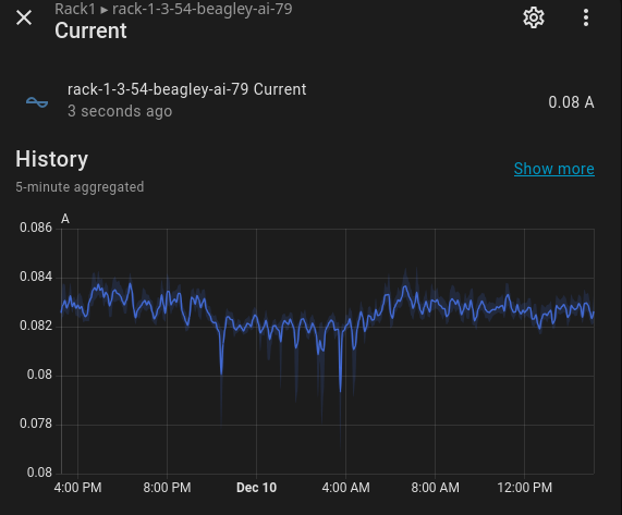

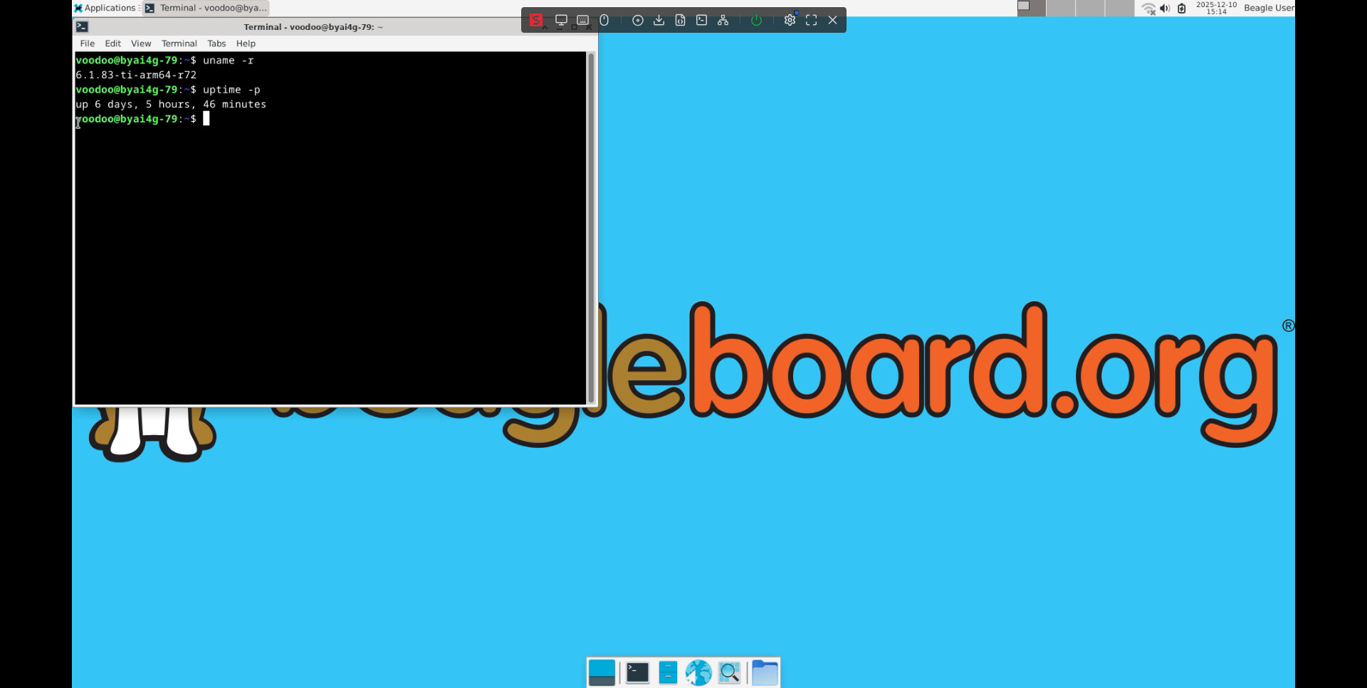

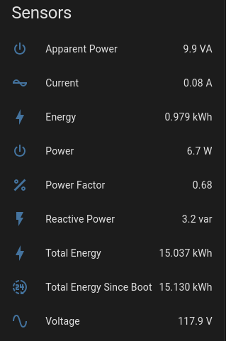

Just idling in xfce.. v6.1.83 production kernel (Debian 12)…
Edit, that current is measured on 120V AC:
Thank you.
A standard AC-DC converter loses around 20%, so it looks like we’re dealing with the same power consumption.
