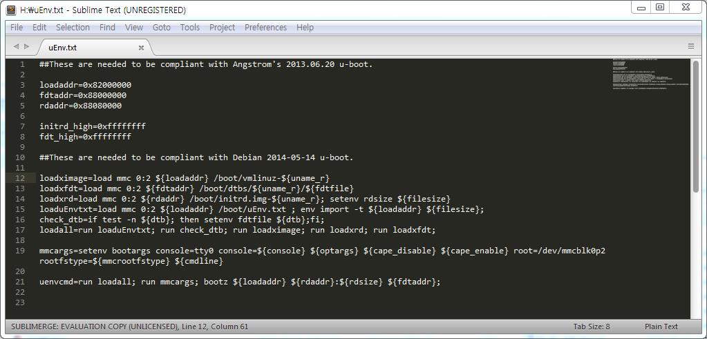

After writing image to uSD, there is no /boot/uEnv.txt
there is /uEnv.txt but there is nothing about eMMC flasher.
Now my BBB is booting with “BeagleBoard.org Debian Image 2015-03-01” if I eject writen uSD.
It's in /boot/uEnv.txt which is on the ext4 partition, what you see there
is the shared windows fat partition which is un-used by the OS.
<https://lh3.googleusercontent.com/-BUy-laj4ZzQ/VfI8P6-LJyI/AAAAAAAAALo/hPcOc-aoGOE/s1600/uSD_writen.JPEG&gt;
<https://lh3.googleusercontent.com/-M_jAI2LWeb8/VfI8UBAqpzI/AAAAAAAAALw/H-nIajQ4OlY/s1600/uEnv.JPEG&gt;

I found /boot/uEnv.txt on linux.
I tied to find it in uSD.
I edited it and success to install latest image.
Thank yoy!
