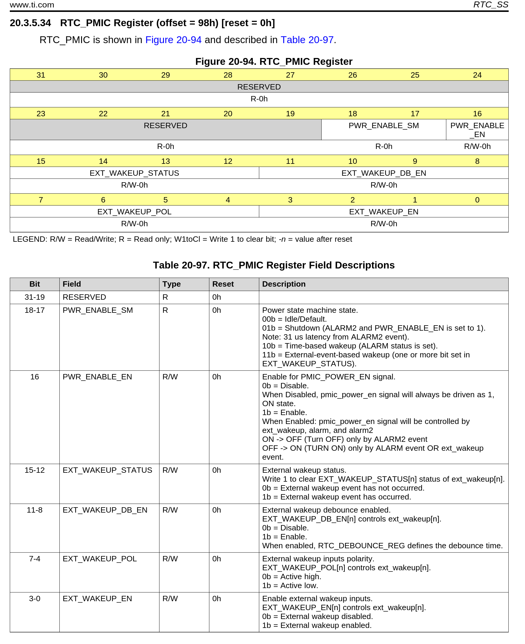

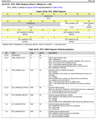

So funny story, it’s actually hiding a RTC wake-up bug on am335x. The designer of the ECO started with the the Black and EVM as reference but tried adding later fixes/optimizations. By the time of final verification and testing, we found that no one had ever got (RTC-wakeup thru EXT_WAKEUP_EN pin) working on am355x devices on mainline. So it was decided to just remove the button that doesn’t work.
The fun part of EXT_WAKEUP_EN is it’s default state (off)… So you need to start the board, tell the pmic to enable it, then shutdown… then the button could work to turn on…
Thanks for the info! Regarding the unpopulated Wakeup-Button I somehow thought it’s the same functionality as the previous Power-Button on the Green-Boards. It was always able to shutdown and wake the system - at least for me. But now that I used tweezers to push the new Wakeup-Button I can confirm that it does not shutdown the system. But okay - the Shutdown-Pin is still routed to the Pinheader P9_09.
