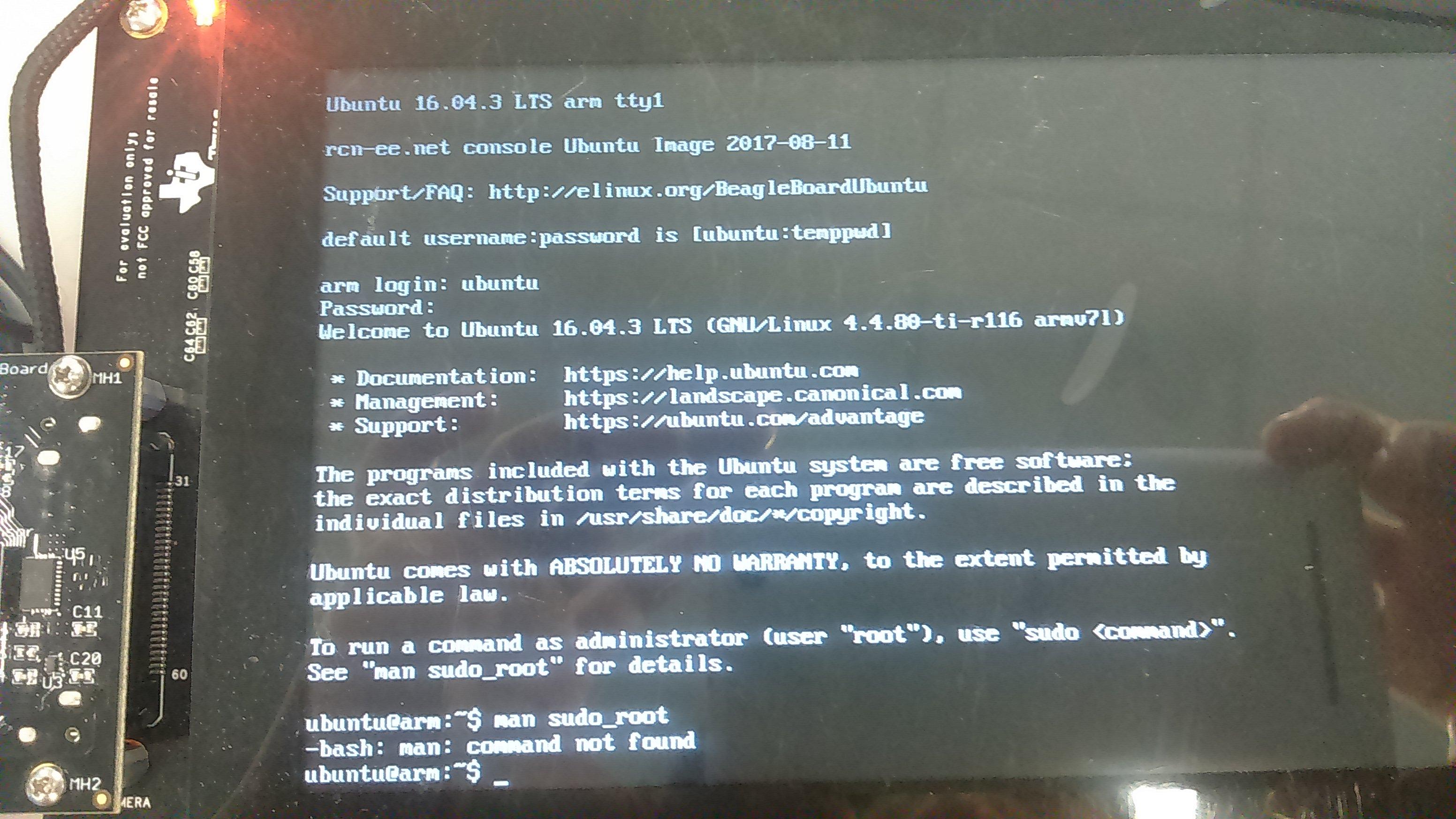

I am a newbie at Beagleboard x15. I want to install the Point Grey camera driver on beagleboard x15. I follow the guide: “Getting started with FlyCapture 2 and ARM”. As requirements, I need to have Linux distribution on Beagleboard x15. Then, I installed, but I was not sure it was right or wrong? Like attached file. And at step 2 of “Installing the FlyCapture SKD”, I don’t know how to copy the driver into beagleboard. Please help me to do that. Thank you.
The console image you installed is very basic to save space. It is a bit geared towards experts. I suspect you’d be better off starting with the default X15 image on https://BeagleBoard.org/latest-images.
To follow learn to follow Linux application install guides, you should first become familiar with the command-line and common commands, including package management with apt-get. I recommend starting with one of the Linux books listed at https://BeagleBoard.org/books.
When asking for help, read the guide on “Smart Questions” at https://BeagleBoard.org/chat. In this case, asking us to go look up instructions will keep us from giving you a complete answer. I suspect you need to get a network connection up, then you can use tools like wget or git to download the software in question.
