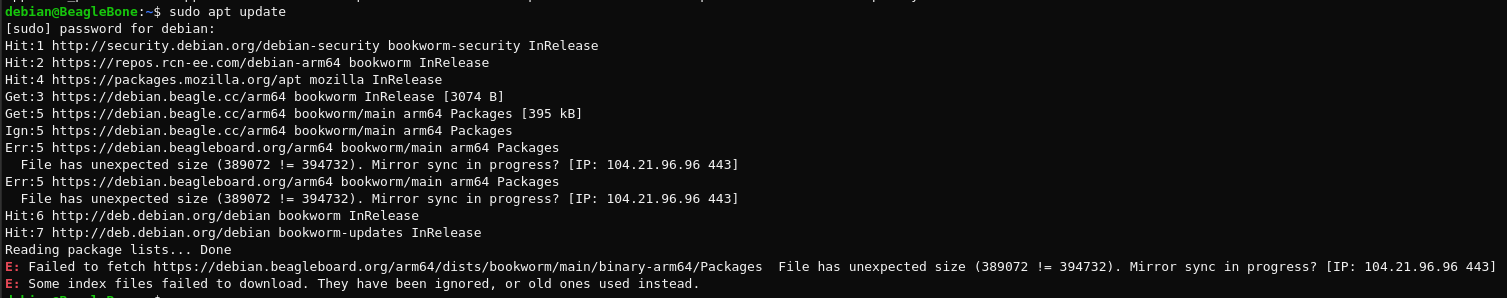

Just pushed an update:
voodoo@byai4g-81:/mnt/lab$ sudo apt-get dist-upgrade
Reading package lists... Done
Building dependency tree... Done
Reading state information... Done
Calculating upgrade... Done
The following NEW packages will be installed:
  firmware-intel-graphics firmware-intel-misc firmware-marvell-prestera firmware-mediatek firmware-nvidia-graphics
The following packages will be upgraded:

One more thing… Now when I do an apt update, I get this issue. Is it related to the push you just did?
Safe to ignore the warning, the cloudflair mirror server is just behind, the main server provided the apt update.
