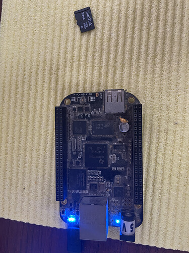

I wanted to boot from SD card and so plugged in a blank new SD card and pressed down the power button and inserted power to burn the image on it. The system booted fine and LEDs were blinking in the way they are supposed to. However I didnt realize that the image would start updating automatically in SD card and took out the SD card while it was being written and deleted the files that had been written on it. Now BBB simply doesnot boot up and only user 0 and 1 LEDs are continously blinking. Ive flashed a new image on the card using etcher and tried booting but it just doesnt work. Can anyone help me in this situation?
State right now is as shown in the pic below

If they are flashing it is running.
Log in on the debug port and see what is going on.
As @foxsquirrel has said, if the leds are flashing the board is running.

Thanks a lot for the help and guidance. I managed to catch a hold of the issue. I was burning a new image on SD card using Balena Etcher from my M1 MAC. I caught hold of my old Intel MAC and downloaded debian 7.5 and BBB started working like a charm.
