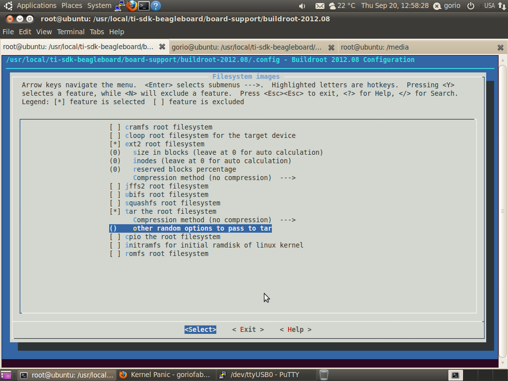

Im new with beagleboard xM rev C and im trying to do a custom Linux using buildroot.
I got this error when i tried to load rootfs

[ 4.084747] EXT3-fs (mmcblk0p2): error: couldn’t mount because of unsupported optional features (240)

[ 4.141601] No filesystem could mount root, tried: ext3
[ 4.149993] Kernel panic - not syncing: VFS: Unable to mount root fs on unknown-block(179,2)

Your root filesystem is using just more then “ext3”, enable the optional ext3 feature configs… (they are right below ext3 in menuconfig, you can’t miss them…)
