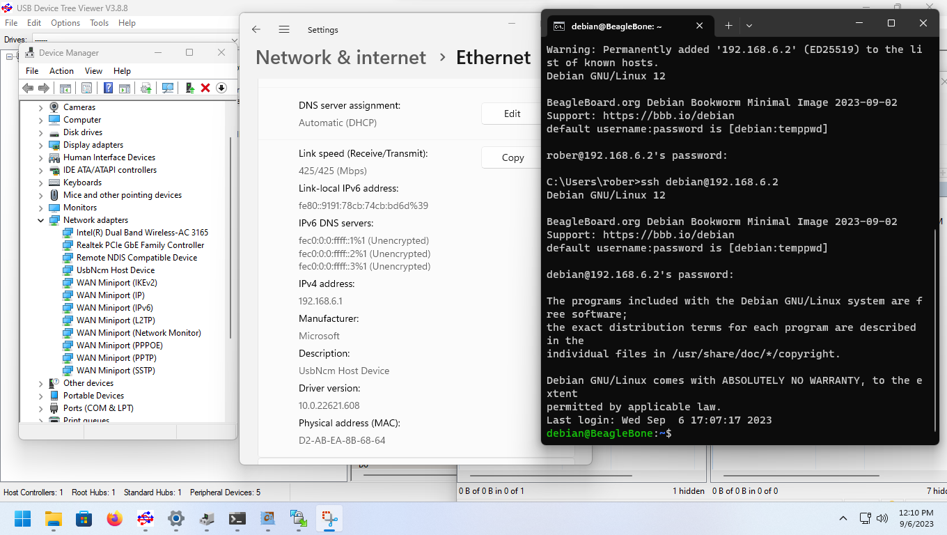

Edit 2:
Ugh: NCM drivers officially shipped with Windows 11 what about 10/8/7 Microsoft!!!
So… @jkridner on Windows 11…
NCM just works… (no 3rd party driver, no nothing, just plugin…)
So we need to build and sign GitHub - microsoft/NCM-Driver-for-Windows: The Windows NCM drivers (host-side and function-side) are the NetAdapterCx based NIC drivers that implements Network Control Model (CDC NCM) specification defined by USB-IF for Windows 7, 8, 10…
Side thought… Since Debian 12.x bookworm release is still really new… do we force only NCM on Debian 12.x + , and thus get the community help us make a signed driver… Or wait till Debian 13.x (2 summers)…
@RobertCNelson thank you for your response. I also saw the in the ncm.usb0 configuration in /usr/bin/bb-start-usb-gadgets, which works perfectly on MacOS. It seems like only Windows 10 will be a problem, but U never knows… I have to verify this when I get some time and will let U know.
