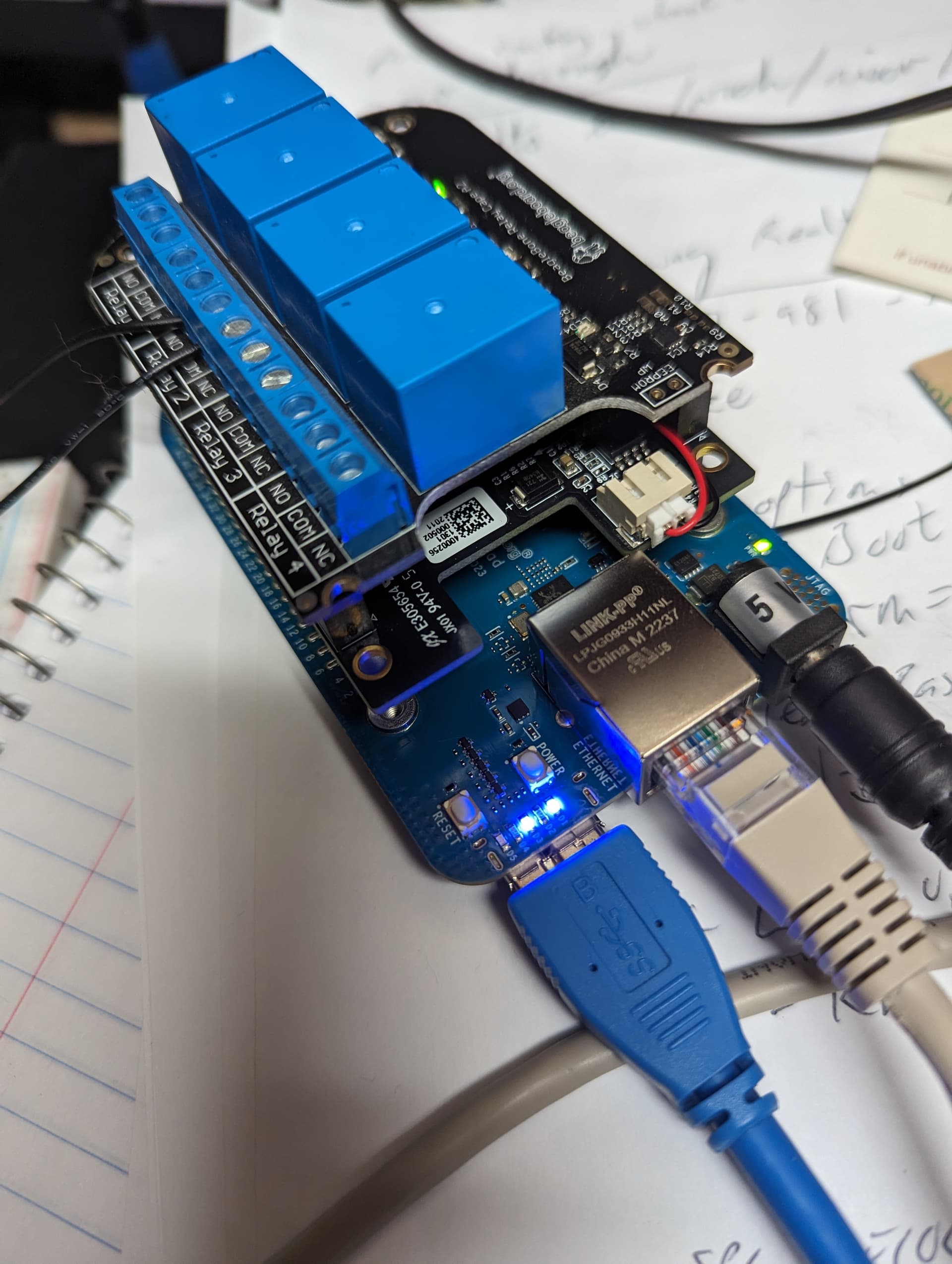

Another Update
https://imgur.com/a/ffUkFvc
So, here is the Relay Cape and Fan Cape working in cahoots on the BeagleV-Ahead! It works. It is alive!

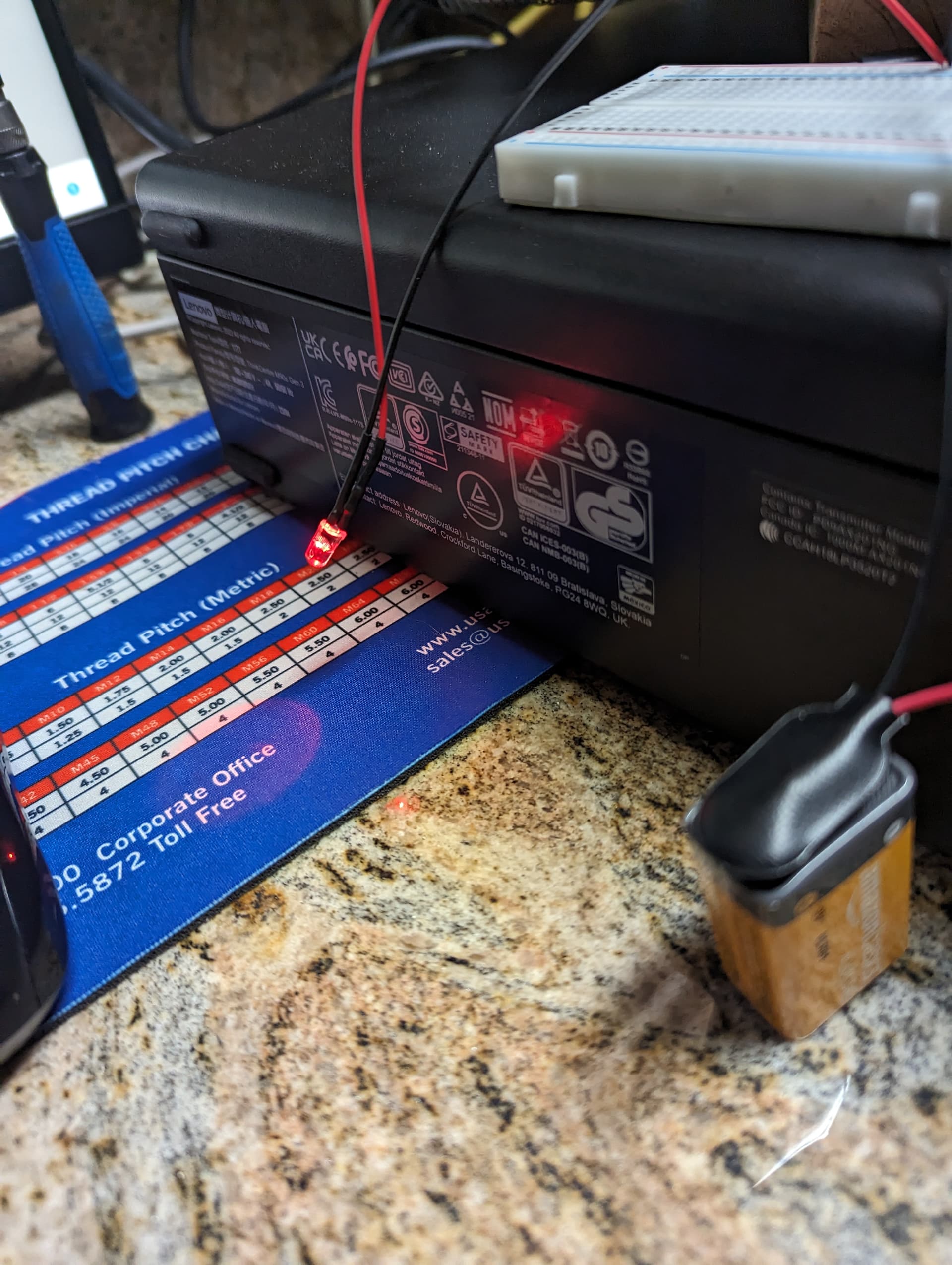

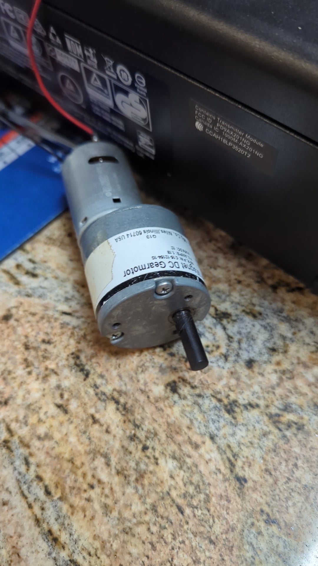

And…there is a small test program w/ brief instructions on motor usage w/ the Load Cape: GitHub - silver2row/loadcape: Load Cape
So, those are some updates in case people are wondering about this specific BeagleV-Ahead and the Load Cape. Oh!
/sys/class/leds is where one can find the files when using the overlay for the Load Cape.
