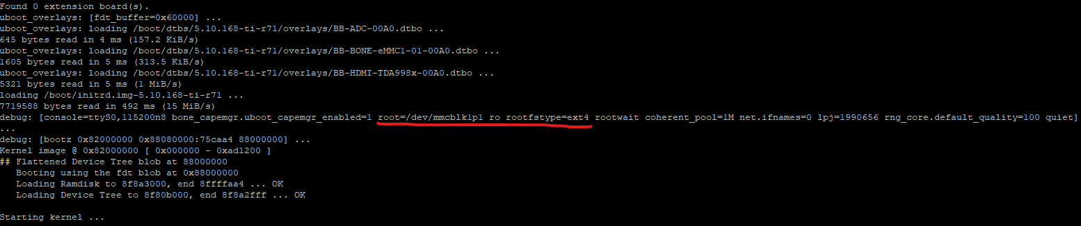

I am trying to boot Linux manually from eMMC using U-Boot commands so I can better understand the booting process. However, booting keeps failing when trying to mount the root filesystem. It doesn’t look like it finds any partitions since the output is blank (see following screenshot):

I got root=/dev/mmcblk1p1 from the output when I just reset my board and allow it to boot automatically. Allowing the board to boot automatically like this works, I can log in. Please see the screenshot below.
Please note that I took out the rootwait so that I could see the kernel panic and other debug output, otherwise it would hang.
