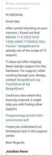

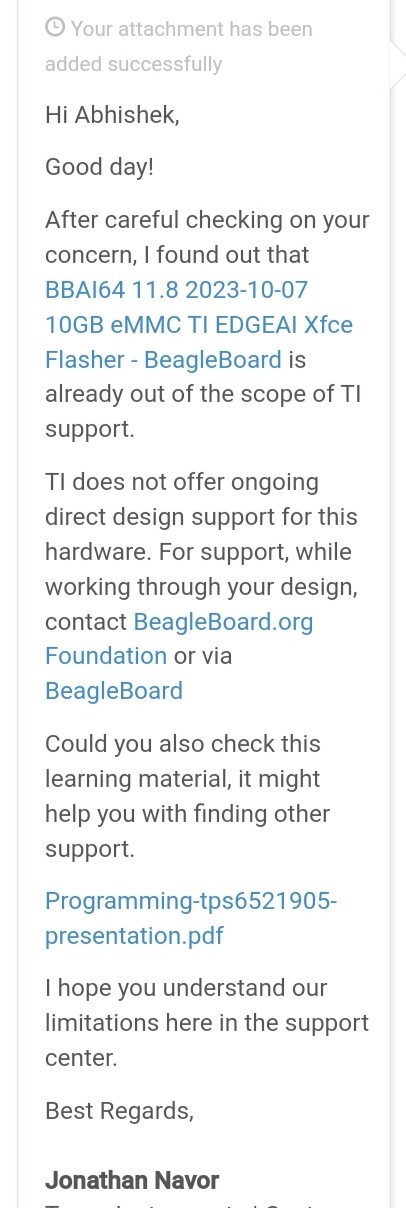

As a part of this I requested yocto support from TI but they are informing that support doesn’t exist for the bbai64. Refer attachments for your reference.
They are asking me to get support from bb.
