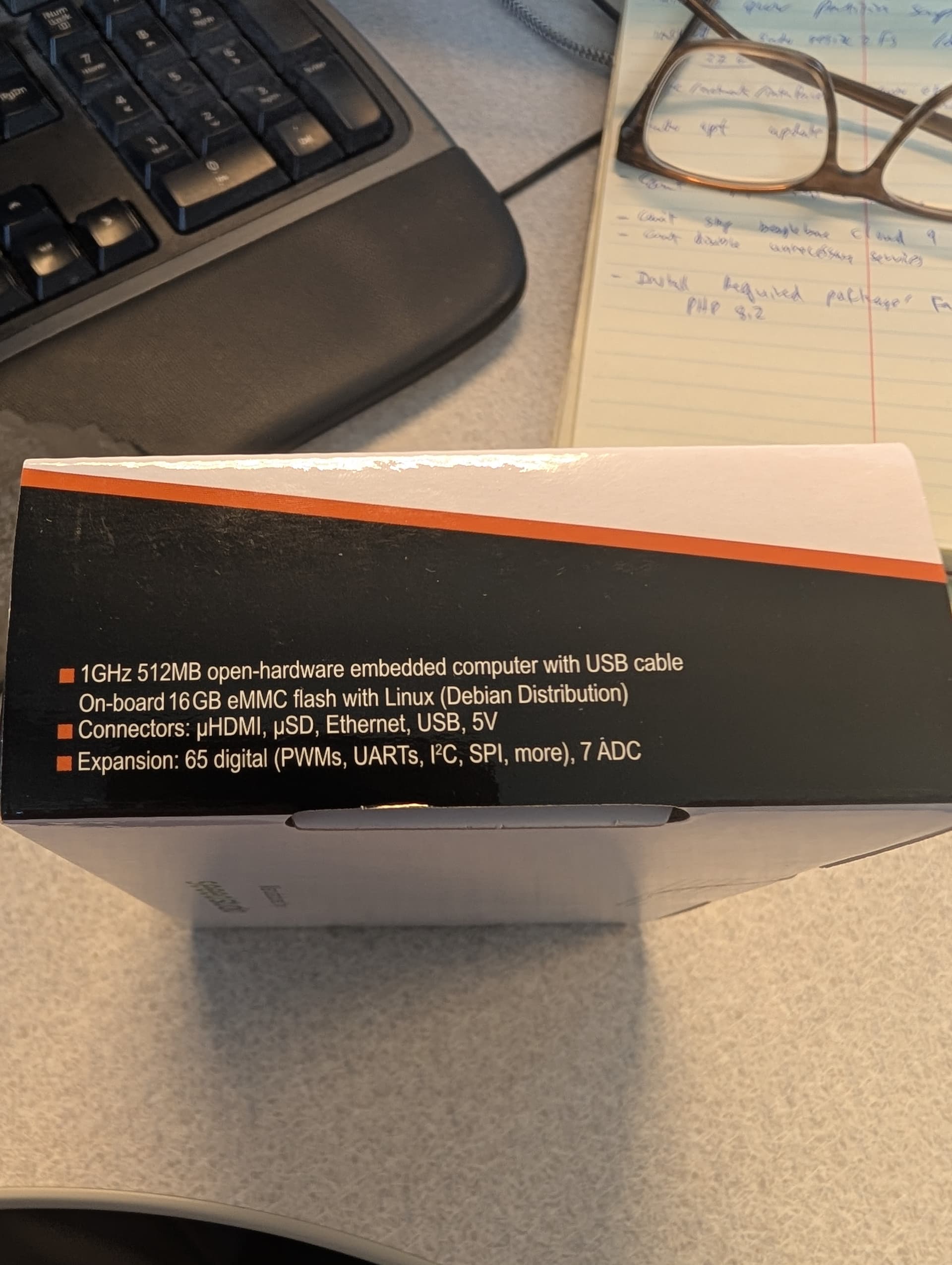

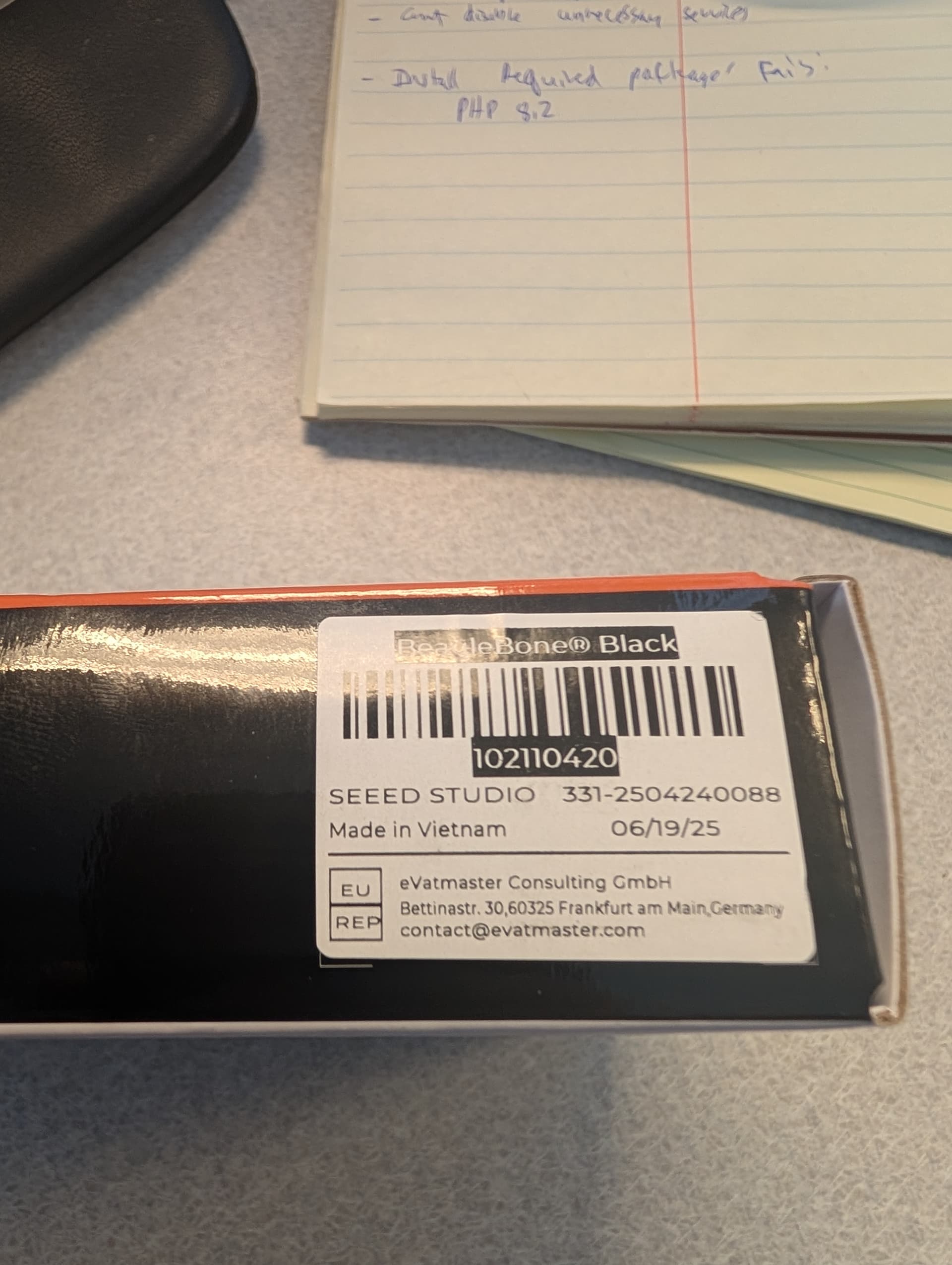

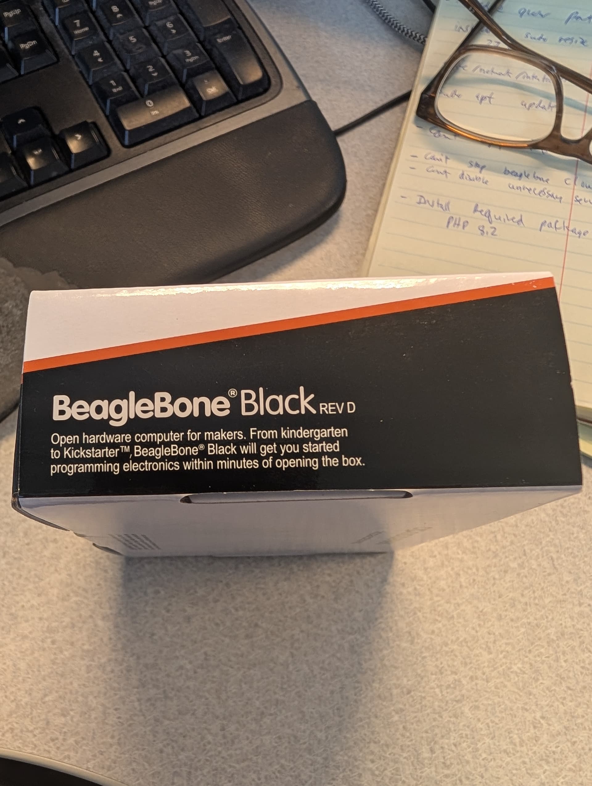

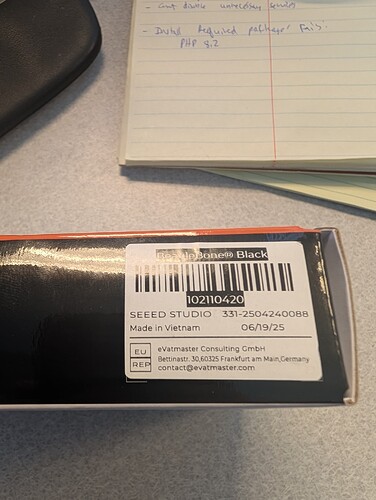

Sorry for being offtopic…
But can you help me with something?
Does the Box that the beaglebone came in still list 4GB eMMC? Or does it say 16GB eMMC? I’m trying to figure out if theres an easier way to determine if a board is new or not
Look for RevD… or June 2025 build date… waiting on a revd box so i can confirm too..
It lists On-board 16GB eMMC flash with :inux (Debian Distribution)
