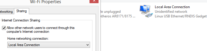

I have beaglebone black and I am trying to access internet over USB from my laptop. I am using putty to ssh into beaglebone But the problem is that when I try to ping my laptop using: PING 192.168.7.1. It fails. Following is the message that shows up on the screen:
PING 192.168.7.1 (192.168.7.1) 56(84) bytes of data.
After this nothing happen. It stucks here and after aborting the process using ctrl+C, it show up this message:
69 packets transmitted, 0 received, 100% packet loss, time 68019ms
How should I ping back to my laptop. It is running windows 8 while beaglebone is running angstrom. Please help…

Ok so I had the same problem with trying to ping from beagle bone black rev C to my windows 8 laptop. Now I could ping from windows 8 but not vice-versa. So what I found out is that Windows 8 by default has a rule enabled to block all incoming ICMP packets. So what you need to do is go to
Windows Firewall → Advanced Settings → Inbound Rules and enable File and Printer Sharing (Echo Request…
