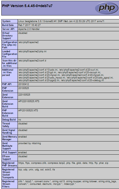

The path where I untared it, unziped it, used the command ./config , make and make install is /usr/local/src/php5.6.30.
Is this path wrong to do all of this?
These is the data displayed both in the terminal and the info.php file.
Have you updated
/etc/php5/apache/php.ini
to point it to your new php location?
That would be exactly what I need, and that’s exactly the point where I’m still a noob regarding linux and web-management issues. What I understand from what you say RobertCNelson, I just have to open the file /etc/php5/apache/php.ini using any editor and change some lines in it, but, the file is quite extensive and I wouldn’t know which lines I’m supposed to modify and what folders I am supposed to point to exactly.
I would appreciate some guidance on this, direct information or related topics that can help me.
