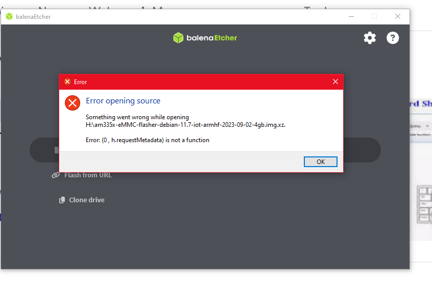

Balenaetcher does not let me select flash icon when I click on it. It does not let me select source drive. My image for Beagle Bone Black is on SD card, along with Balenaetcher.

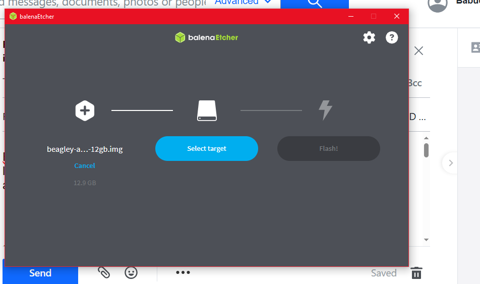

Side note, the minimal microSD size required is encoded in the file name… device-image-type-date-12gb.img.xz = a microSD bigger than 12GB, so the 32GB is perfectly fine.
Side note #2, what board are you using? beagley-a* in your screen shot means your setting up a BeagleY-AI… But your first message said, BBB, or BeagleBone Black…
The BeagleY-AI image will not work on the BeagleBone Black.
No idea if a 1.5TB SD card would work, that’s high end SDXC spec… We are lucky SDXC does work on smaller cards (64GB/128GB), the IP on the am335x was designed for SDHC…

What is your H: drive?
> Need to see the information behind the Error dialog box. Move the dialog box up to the left or right and re-post the image.

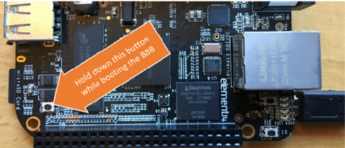

Did you hold down button shown before you plugged USB cable into USB slot?
Once lights start flashing you should be able to release the button
At this point the image on the microSD is being flashed to the 4GB eMMC.
After lights stop flashing the BBB should power off.
This is normal. You need to reboot the BBB.
Remove the MicroSD card.
Remove and reconnect the USB cable.
The BBB should boot.

I followed instructions at Updating the OS software image on a BeagleBone Black by Zageo LLC Medium.pdf.
I starting at step 10.
Disconnect USD cable and Ethernet cable (if attached)
Inserted MicroSD card into uSD slot
Hold down button shown and plugged USB cable into USB slot.
Remove the MicroSD card and reconnect the USB cable.
