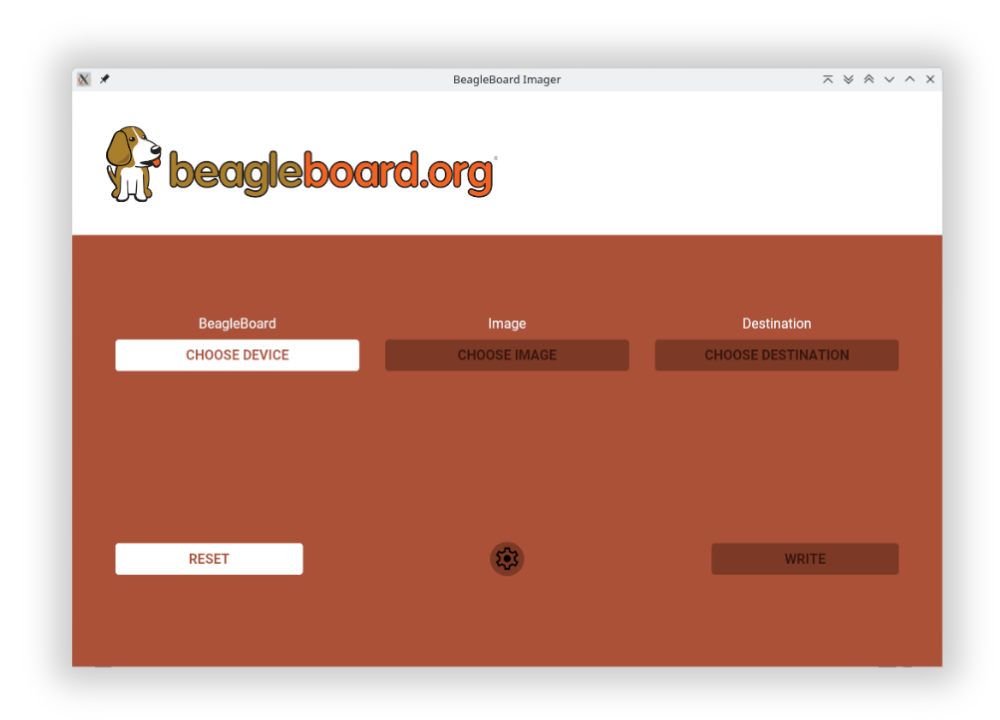

I am trying to flash an image to the PB2. I got one of the images on bb-imager to flash but I had to take dhcp auto off of the options picked.

@RobertCNelson , I cannot get an image from the 0.0.7 version of bb-imager to boot a properly built image from within its confines.
So, bb-imager offers Board -> Image -> Done. No matter what image I pick or if I choose DHCP on or off or auto or ON/OFF and any image, I cannot use it.
I can boot dhcp off images for the PB2 for most of them. The others just do not boot with 0.0.7 of the bb-imager source.
Do you have another idea I can try or should I reach out elsewhere?
Which exact image are you flashing thru bb-imager-rs?
I am not using -rs. I am using the 0.0.7 version of bb-imager.
I am using this one on…ut oh.
Maybe my silly self installed the Windows Version for Ubuntu. Blah.
zip files. I need to go and check.
Just a heads up here. I could not understand what to do with the bb-imager-rs files from openbeagle.org.
Which of the 3 images it recommended did you use?
Bookworm and all.
I tried all.
I tried the Bookworm minimal and Bookworm IoT and Zephyr.
