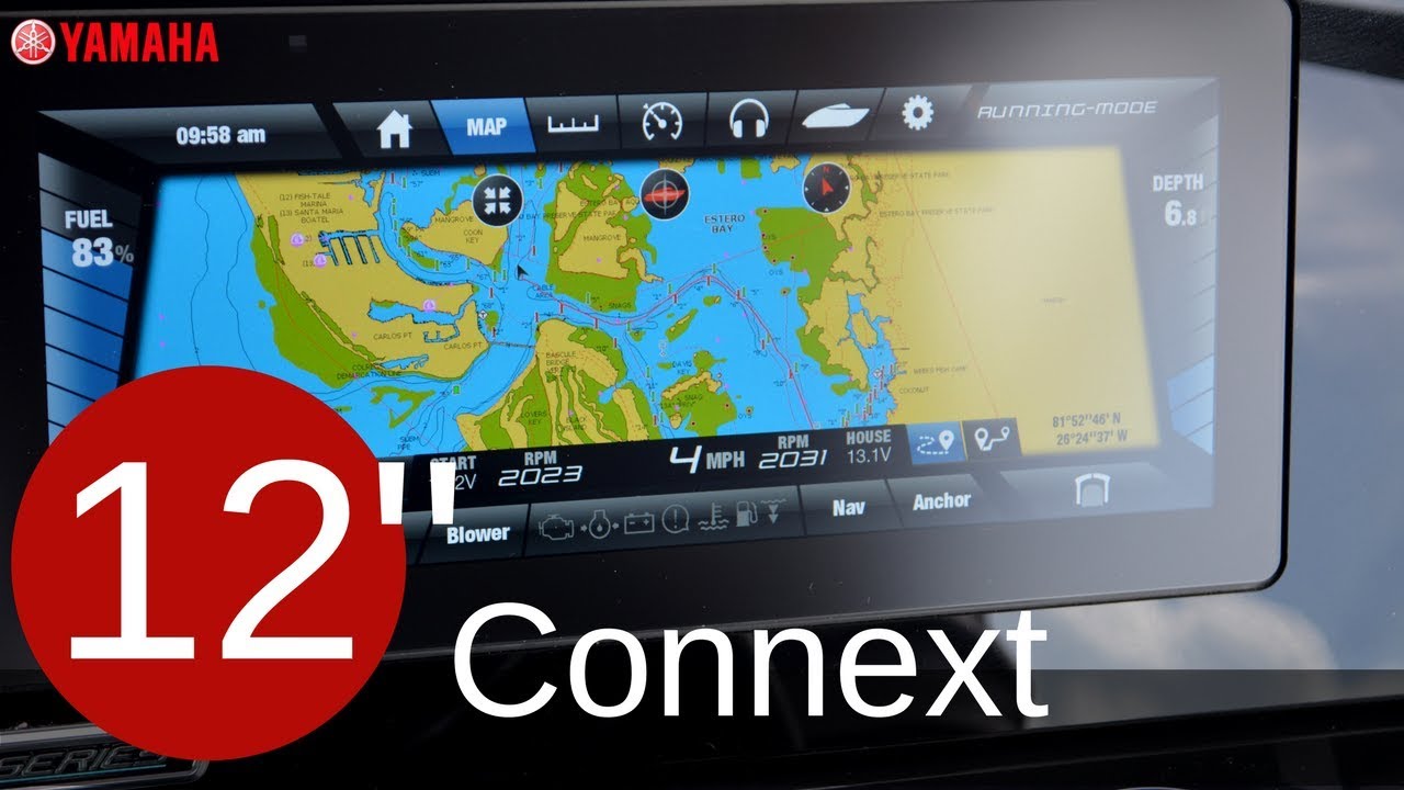

Basically I have a rootfs that compressed and then I use a script to create the image using losetup just like I did when I created the linux for Yamaha boats. That linux was with yocto with a DRA726.
