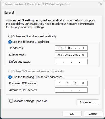

  9. Enter the following information following by pressing the OK button.
  10. Now you can SSH into your PocketBeagle2 using the same 192.168.7.2 and do a ping www.google.com to verify connectivity to the outside world
