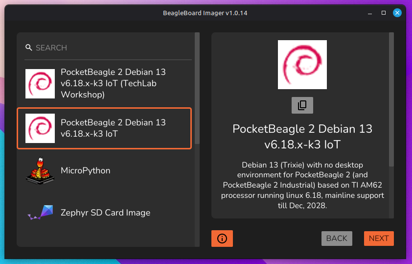

I bought my PocketBeagle from Digikey a few weeks ago, was very excited. I got a new laptop to develop with, got the network device configured for sharing, burned the recommended SD image,
It boots. I can ssh to it, I got git to install, started cloning my project and - hang.
No further progress.
Reset, reboot, try again, hang.
Is there a hidden update or something that I need to install? Or did I just get a bad board?
If the board is no good, it’s a bit disappointing, but if it’s software at least it can be fixed.
Please let me know if it’s just this example!
So with the PocketBeagle 2, everything is on your microSD, if it hangs something is going on, best to plug in the usb-serial adapter.. (little 3 pin jst header on the side of the board).. You can use the Raspberry PI debug cable: https://www.digikey.com/en/products/detail/raspberry-pi/SC0889/17877576 available locally most places..
Is there a special breed of microSD that works best? I just got big ones.
-jrl
Just get a high endurance SanDisk from a reputable vendor and you should be good.

There’s an interesting gap from 0.17 to 1.33, but what I really wanted
was to see was the Oops; terribly needy, I know… :wink:
I got the debug cable and set it up, it is clear now that the hang (which I still get,
every few seconds when using ssh to access the board) is not the entire thing.
It’s the network - it goes dead. No breadcrumbs yet, still looking.
Please share the part of the log you see.. are you over a wifi link?
screenlog.0 (885.5 KB)
I didn’t try to edit the file, it has several boot sessions in the log.
I didn’t see anything get logged when the ssh from the host got hung, but the host declares the ssh IP unreachable afterwards, although the interface still responds to pings.
Ah your running the “workshop” image..
Without the required hardware it’s not very useful:
PocketBeagle 2 microSD (extlinux.conf) (swap enabled)
1:	microSD (failsafe)
2:	copy microSD to eMMC
3:	microSD (debug)
4:	microSD
5:	techlab
6:	techlab workshop (default)
Enter choice: 6:	techlab workshop (default)
Retrieving file: /Image.gz
append: console=ttyS2,115200n8 earlycon=ns16550a,mmio32,0x02860000 root=/dev/mmcblk1p3 ro rootfstype=ext4 fsck.repair=yes resume=/dev/mmcblk1p2 rootwait net.ifnames=0
Retrieving file: /ti/k3-am62-pocketbeagle2.dtb
Retrieving file: /overlays/k3-am62-pocketbeagle2-techlab-cape.dtbo
Retrieving file: /overlays/k3-am62-pocketbeagle2-leds-off.dtbo
   Uncompressing Kernel Image to 0
## Flattened Device Tree blob at 88000000
   Booting using the fdt blob at 0x88000000
Working FDT set to 88000000
   Loading Device Tree to 0000000098ecb000, end 0000000098ee1fff ... OK
Working FDT set to 98ecb000
It’s expecting to see this, https://www.digikey.com/en/products/detail/ghi-electronics-llc/TLAB-PBCAPE/9932447 or the newer version @jkridner has been working on..
OK that explains some of the “not ready” messages - I don’t care about
anything but I2C ports 1, 2, 3 and the serial debug, for this application,
so which version should I use? Is this just a boot option, or one of the other
images is recommended?
Sorry to be such an ignorant nube, I used a BeagleBone for a project a
couple of years ago and it was a great success - no such teething problems.
Presumably other people already had the arrows in their backs for which
I thank them with the most fervent appreciation! It’s fun, but shipping delays
to get the right debug equipment make it frustrating…
Just grab this instead:
Thanks - will try it.
-John
