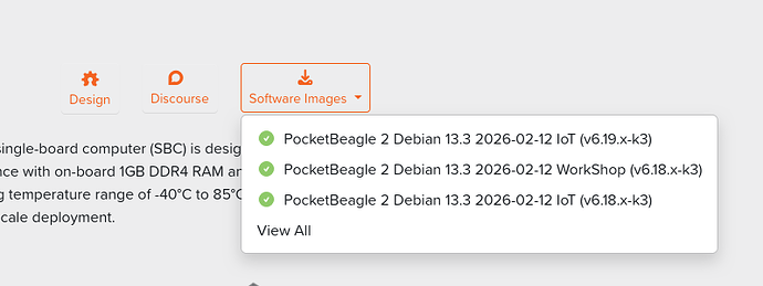

Also the dropdown box on the product page for the software images is not populated which made me concerned.

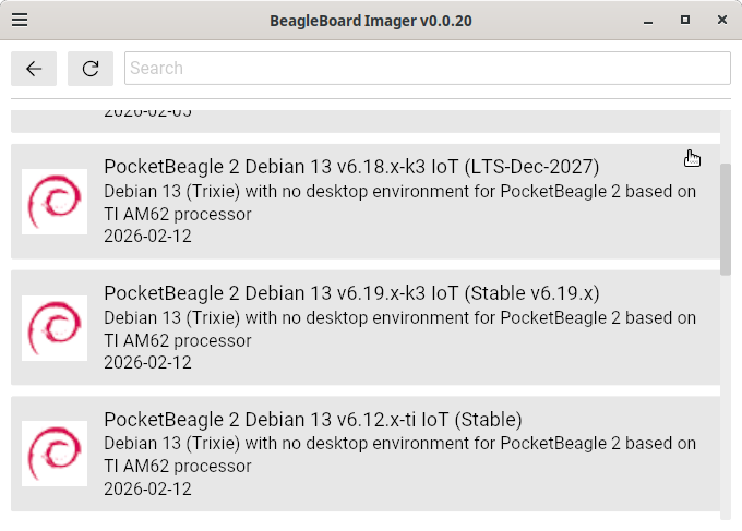

Use the v6.18.x-lts image:
Or anything ‘after’ 2026-02-12 …
Updated json’s description: ci: cleanup text for PB2 to add PB2I · beagleboard/image-builder@f845416 · GitHub

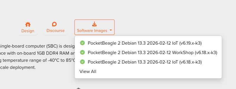

Edit and thanks! fixed:
That’s great. Thanks.
