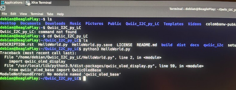

I went through the process of downloading the libraries in the terminal and when I run the code it gives me “No module named ‘qwiic_oled_base’.” I have also tried running some code with some other libraries and it seem to give me the same issues. I’m pretty new with this board so there is probably a lot I can learn. Do you have advice on how to download libraries correctly and any specific common issues that people run into during this process? Here is a photo of the error message.
You should paste the output from your console here such that specific feedback can be provided, rather than screenshots.
Please provide as much of your log as you feel comfortable. More information is better.
Your issue looks like a Python one, not specific to BeaglePlay.
It seems you used pip to install a module. I don’t see that specific log. Often, when using pip, it is wise to use venv as well to give the modules a specific place to go as it otherwise is in conflict with the Linux distribution’s Python packaging.

If you are still stuck, I’ll record the process of doing this, but it comes down to a lack of experience with using Python modules with pip. I’ll try to improve the article with more background on using pip and venv.
Yes, that is true. You might need to symbolic link to resources outside the venv, (CUDA, PyTorch, OpenCV) are some that are touchy. When in doubt do a native install for a sanity check, if that works track down missing files and symlink to them.
