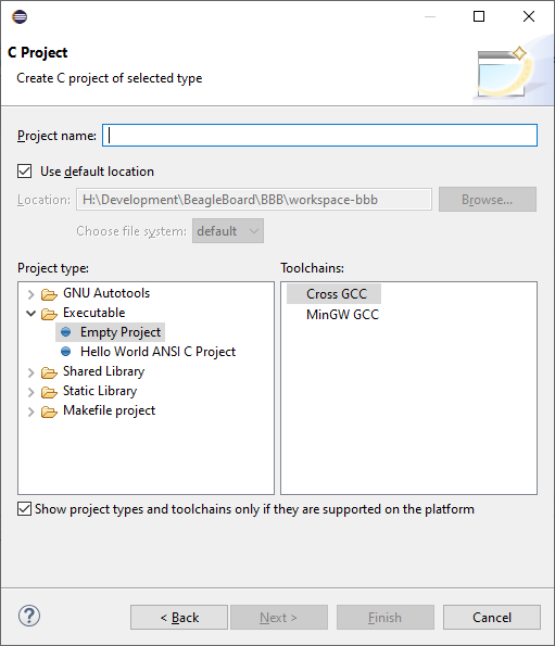

As suggested, this time, I have tried with “gcc-linaro-7.5.0-2019.12-” and eclipse 2019, I am able to build and run the project, again on host.
But still unable to find the options to change cross -compiler settings in eclipse 2019. Please see the pic attached,
Can you please share pic where to change settings in eclipse.
Where to enter the following.
Prefix: arm-linux-gnueabihf-
Path: “Path to the toolchain”
thanks in advance.
You may need to unpack the archive as administrator on windows.
Run your extract program as admin, then select the archive and extract it …
When you create your project, ensure you are selecting “Cross GCC” and not “MinGW GCC”. The MinGW is for windows dev.
Ex:
Jon
This clarification helps, let me try this. thank you.
