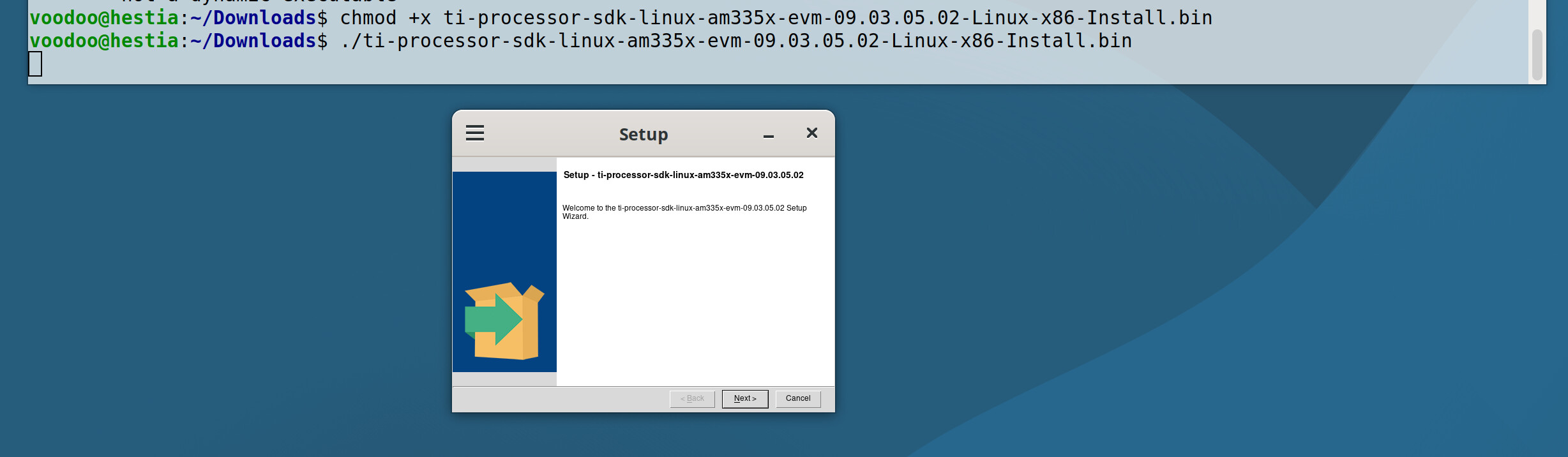

voodoo@hestia:~/Downloads$ sha256sum ti-processor-sdk-linux-am335x-evm-09.03.05.02-Linux-x86-Install.bin
aab745e9c4d5184eee76eec725423b3f46185dbf72dc7e975f9eb1d7b5be4ee9  ti-processor-sdk-linux-am335x-evm-09.03.05.02-Linux-x86-Install.bin
voodoo@hestia:~/Downloads$ file ti-processor-sdk-linux-am335x-evm-09.03.05.02-Linux-x86-Install.bin
ti-processor-sdk-linux-am335x-evm-09.03.05.02-Linux-x86-Install.bin: ELF 64-bit LSB executable, x86-64, version 1 (GNU/Linux), statically linked, no section header
voodoo@hestia:~/Downloads$ chmod +x ti-processor-sdk-linux-am335x-evm-09.03.05.02-Linux-x86-Install.bin
voodoo@hestia:~/Downloads$ uname -a
Linux hestia 6.16.7-r1 #10 SMP PREEMPT_DYNAMIC Tue Sep 16 08:52:50 CDT 2025 x86_64 GNU/Linux
voodoo@hestia:~/Downloads$ lsb_release -a
No LSB modules are available.
Distributor ID:	Debian
Description:	Debian GNU/Linux 13 (trixie)
Release:	13
Codename:	trixie
In case your x11/wayland is the issue, you can use these options:
voodoo@hestia:~/Downloads$ ./ti-processor-sdk-linux-am335x-evm-09.03.05.02-Linux-x86-Install.bin --unattendedmodeui none --mode text
