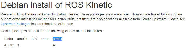

I see from here that ROS Kinetic binaries are claimed to be available for Debian/ARM64. I have not tested it, but will do so shortly as I will be giving a short course on ROS next month and will be once again using the EDUMip as a teaching robot in this short course. Best Regards, -Louis
