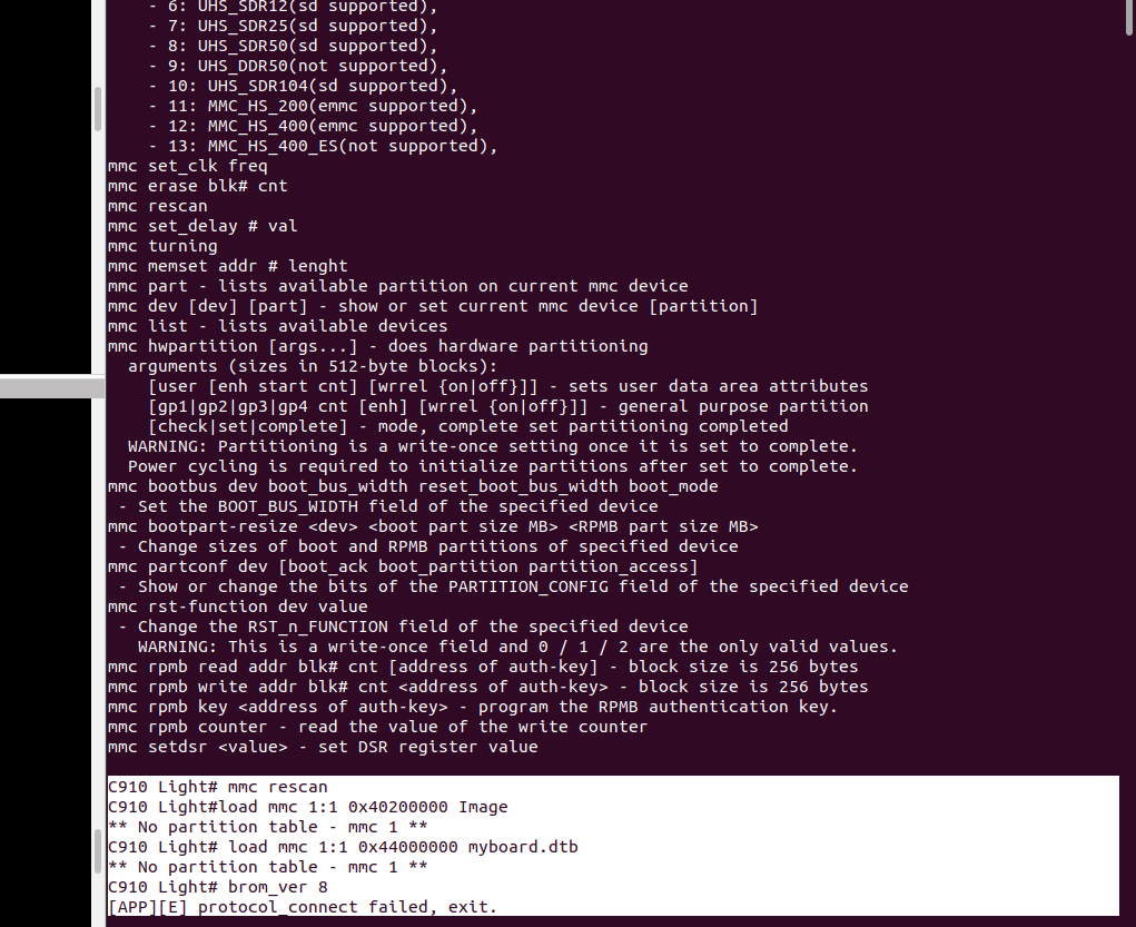

When I was trying to boot from the SD card, the system was taking the boot image from the eMMC by default. It also showed the error: “Card did not respond to voltage level.”
I’m currently using kernel version 5.10.113 For the BeagleV Ahead board, which kernel version should I use, and what configuration changes do I need to make? Is there any misconfiguration? Why is it not able to boot from the SD card?
erase the emmc, then boot from sdcard
