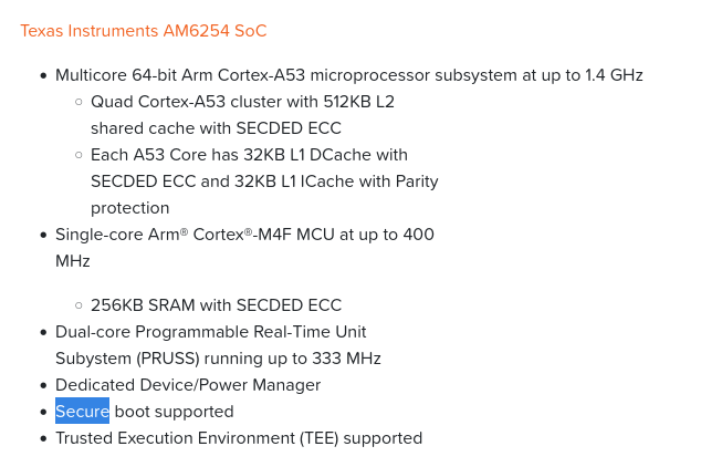

The feature list on PocketBeagle 2 - BeagleBoard mentions “Secure boot supported”. Is that outdated?
@jlu thank you! Yes that is misleading..
The “AM6254” supports Secure Boot but the “PocketBeagle2” Design does not (after TI tested)
I’ll nuke that point. @lorforlinux
