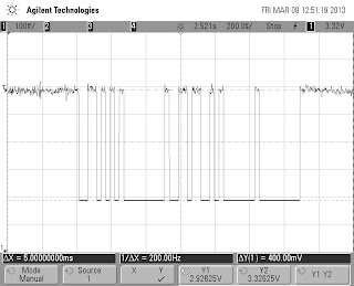

I’m trying to program a serial connection in C and while debugging I measured the following output on my TXD pin. The output is constantly high (3.3V) until some data is sent, which is to be expected. However, the low voltage measures at 2.9V which is still considered a logic 1. Does anyone have any idea why it wouldn’t be between 0V and 0.8V which would make it a logic 0?

Hi Gerald, thanks for your help but there’s nothing else connected. I have one wire coming from P9 pin 1 which the scope’s ground is clipped onto and another wire from P9 pin 24 which the scope’s probe is hooked onto. Those are my only connections. The board is powered by USB. The TXD was configured using:

Sorry, false alarm. I just had the scope configured wrong, everything is working as expected now.
